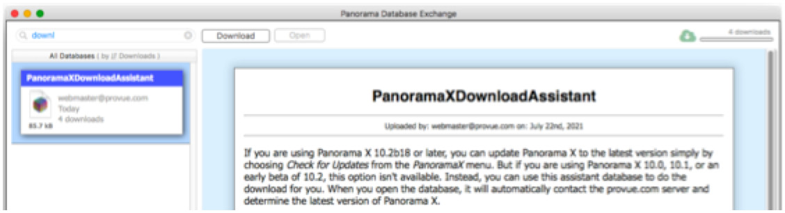

On one Big Sur computer to all went as expected. On another I got the message below when the download seemed to be completed. When I clicked OK the download window just sat there,. I clicked on the Download link again and it offered to Install and Relaunch, which it did without further issues. On El Capitan it worked just fine.
Your screenshot doesn’t show it, but I think you must have clicked on another window while the download was in progress. I think Paul did that also. I reviewed the code, clicking on another window would definitely cause this problem. After seeing this I realize that someone could even close the update window after starting the download! which would also cause problems. I think I have fixed both of these problems, but you won’t really see the fix working until you do upgrades from b21 to b22 (since the next time you do an upgrade you will still be using the b20 code, which doesn’t have the fix).
