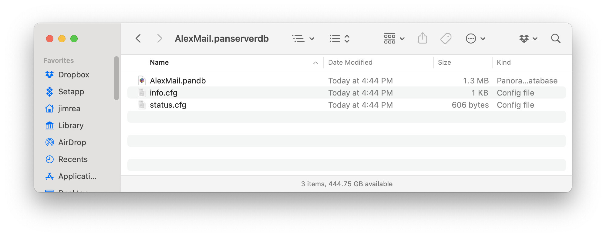

Good news (I think), I was able to upload your database to my server with no problem. Here’s a screenshot of the package contents of the server database in the Public Databases folder.
So it would appear that the database isn’t the problem.
