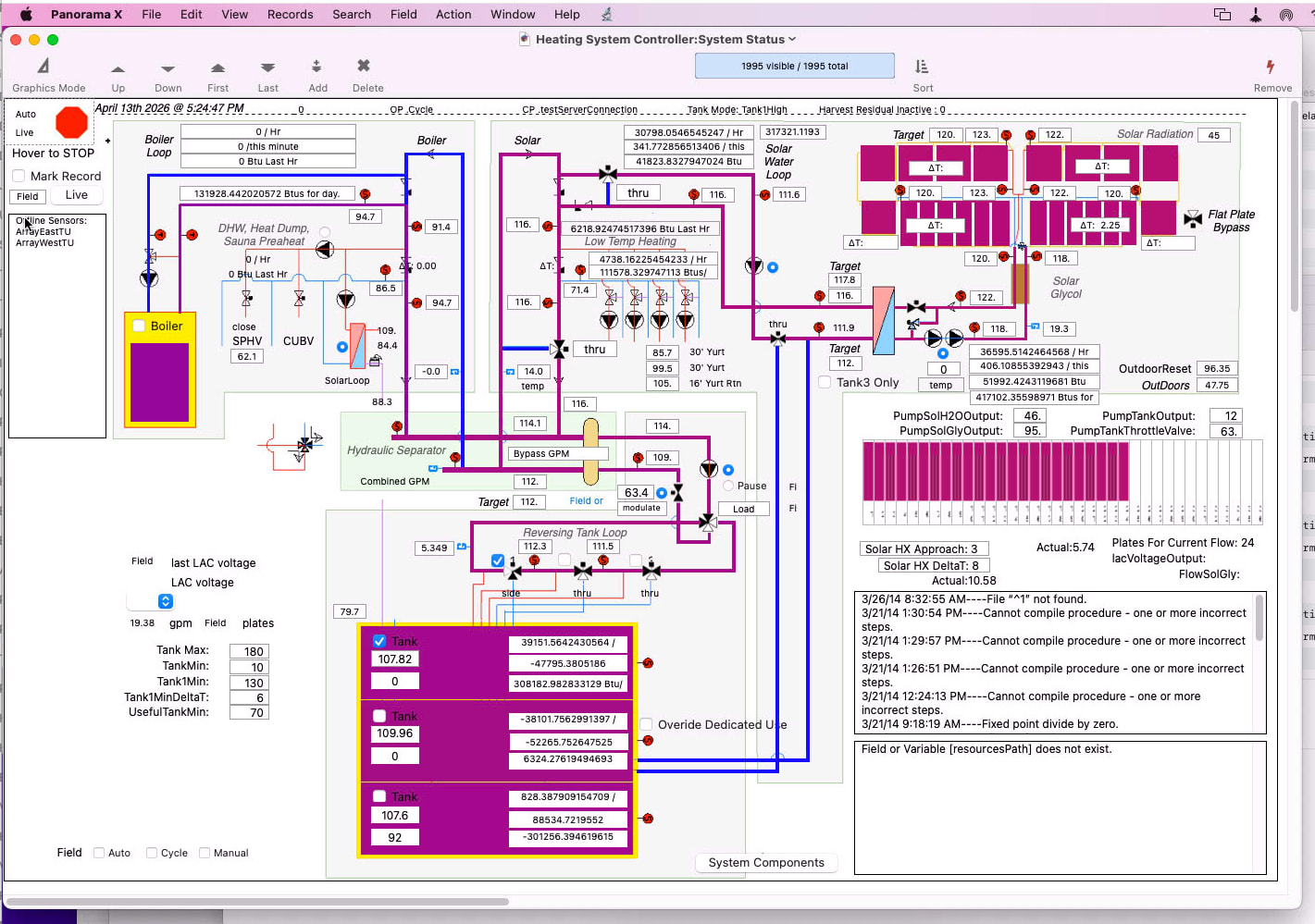

The ‘program’ is my Heating System Controller software, which is meant to run 24/7. I don’t use Panorama X Server. The .UpdateServerSensorFile procedure is called just after the .Initialize procedure as the live control of the heating system begins.

I do need the System Status window open for the Heating System Controller, as it lets me visually monitor temps, valves, and pumps.
That’s fine, I’m just suggesting that the code should work independently from that or any other window.
And since you’re using that (very nice!) form, even more reason to use timers. The way you’re doing it now, everything is non responsive while your code is running. With timers, it won’t be frozen except for once per hour.
