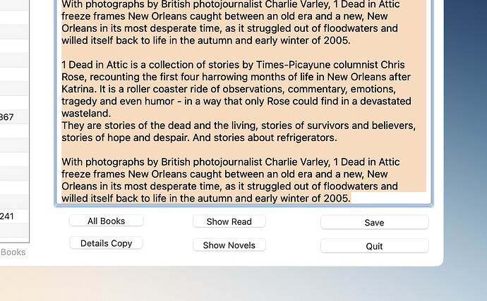

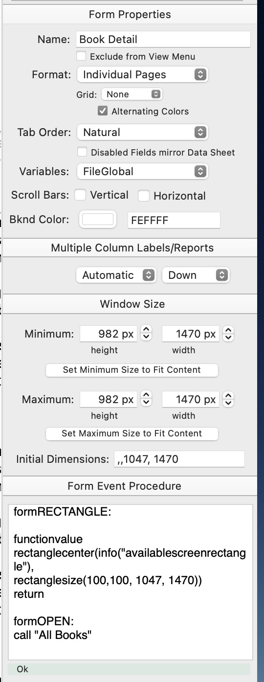

I have a form named “Book Detail”. The form properties are set to have a fixed window size (cannot change window size). Additionally, the scroll bars property for vertical and horizontal are not checked in the form properties.
I have field named “Description”. I have it set to allow vertical scrolling. As a test, I have filled the field to have more text than can be displayed so one would need to scroll down to see the entire text.

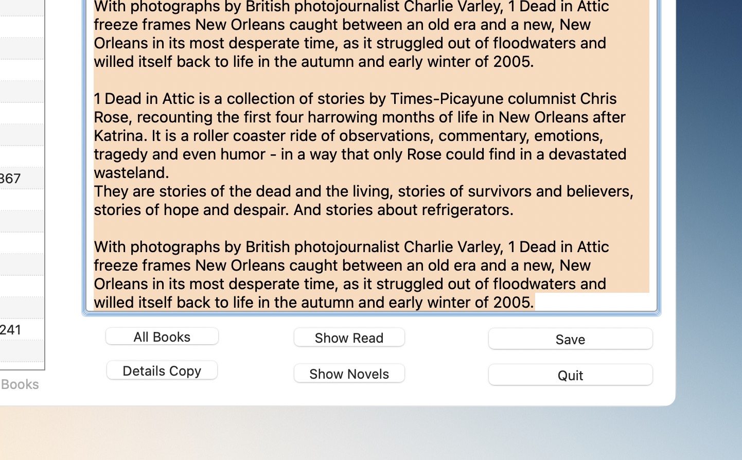

If I click, hold, and drag down to select all of the text, the scroll bar appears and everything works as expected.

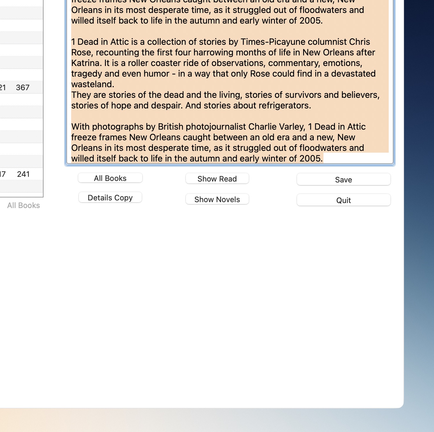

If, while when I’m dragging downward, I have the cursor outside and below the window, the entire form scrolls and I can only view part of the form. A user would have to quit and restart the database to see the entire form. Note: the form background is white; my desktop is the pinkish/bluish area.
The form window should end slightly below the bottom of the buttons on the bottom row, but now shows blank space. I thought, because I had a fixed window size, this would not happen.
