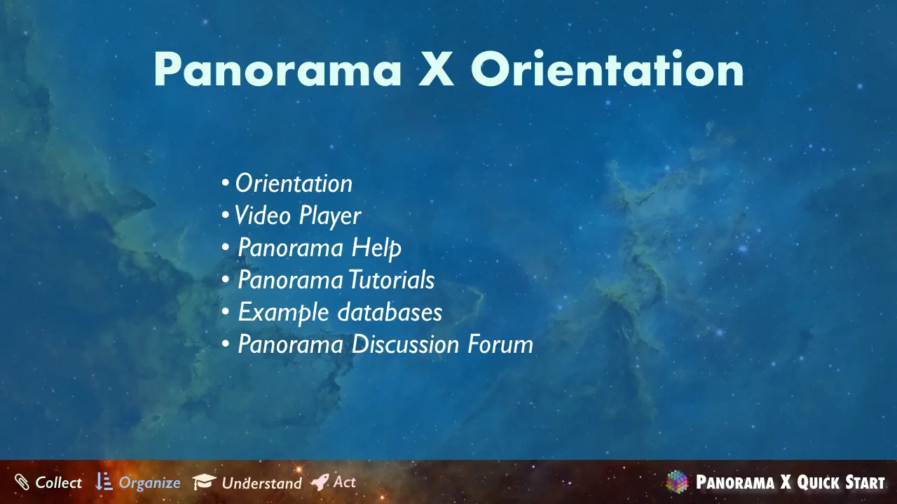

Since no one has mentioned it so far, I should note that there is a help page for the help wizard.
Also, tips on using the help are covered in the Panorama X Orientation video.
