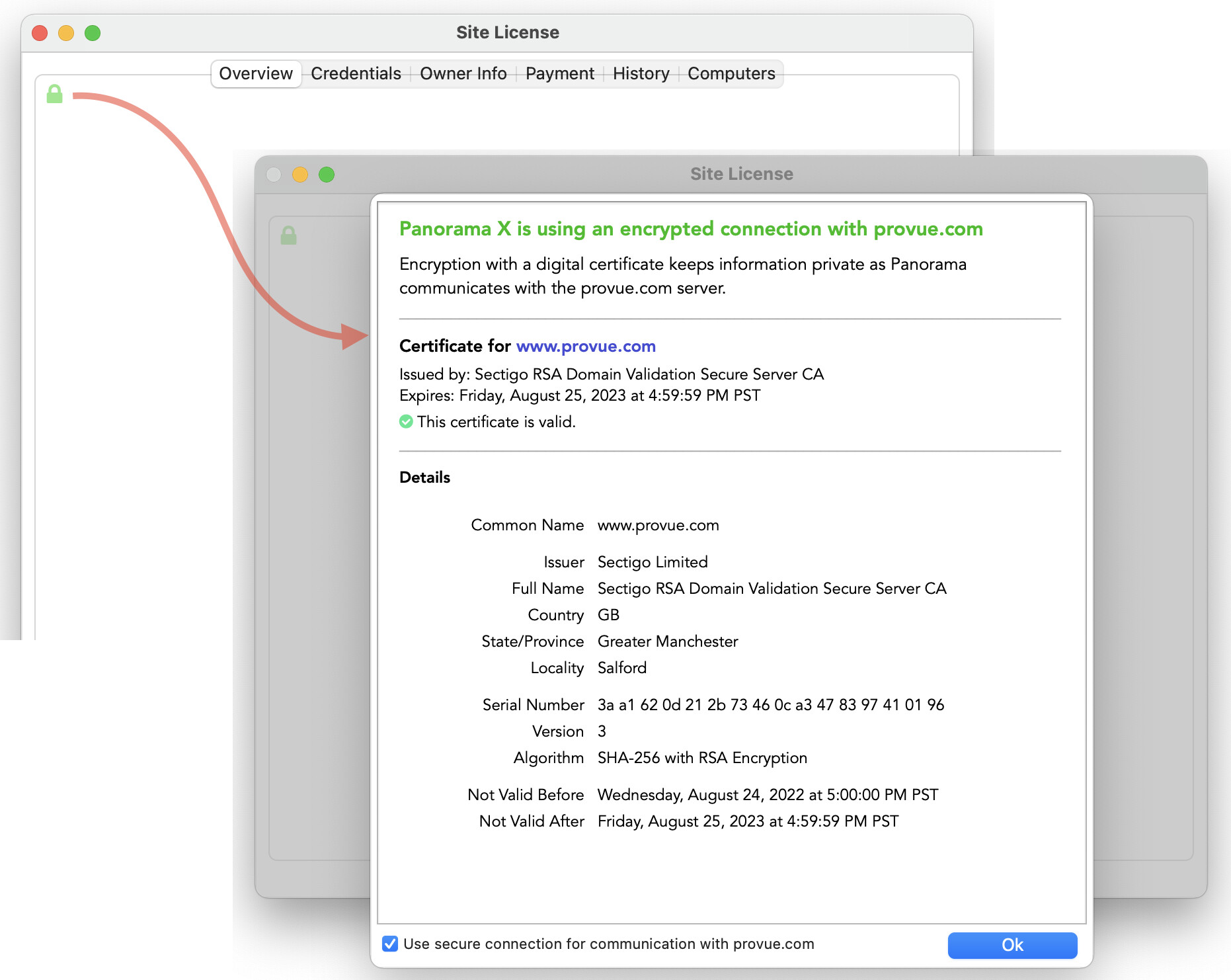

It sounds like their ISP is blocking the SSL encrypted connection to provue.com, or maybe the local router (for example a poorly configured proxy server). I’ve seen this before with Japanese ISP’s (though very rarely). The best solution would of course get the ISP to stop doing that or fix the router configuration. However, Panorama can be configured to not use SSL. To do that, open the Site License window and click on the green padlock. It should look like this, but I’m guessing it will probably display an error message.
To turn off SSL, uncheck the box at the bottom of this dialog, then press ok.
Now the padlock will be gray and unlocked.
