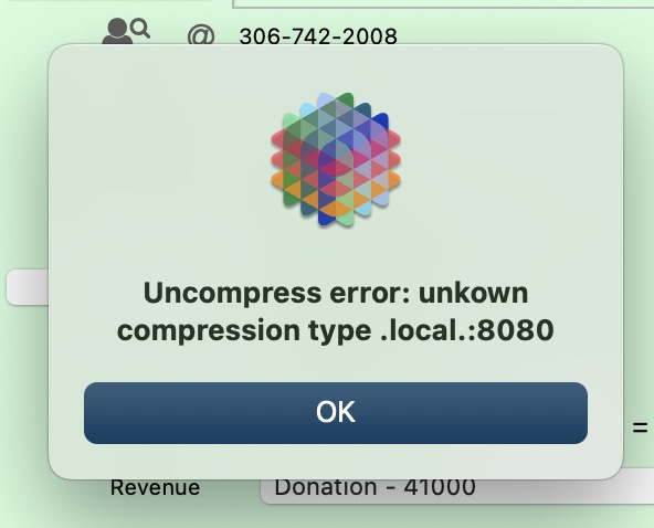

One of the first symptoms of the problem was a dialog on a client machine:

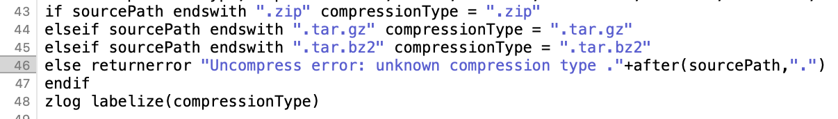

Once the server has prepared a .data.zip file, the client downloads it, and then uncompresses it. To do that, it checks what sort of compression it is, using this simple code:
So what this tells me is that the file that was downloaded was not .data.zip, but ended in .local:8080. Yeah, I’d say that is unknown. Actually, it is the IP address of the server, or at least it would be if the client software is running on the server. But that should not be the filename. Maybe the server problems are winding up with this bogus filename being sent to the client? It should handle the error. Of course, I never did test the system with broken permissions on the server!! No one expects the Spanish inquisition.
