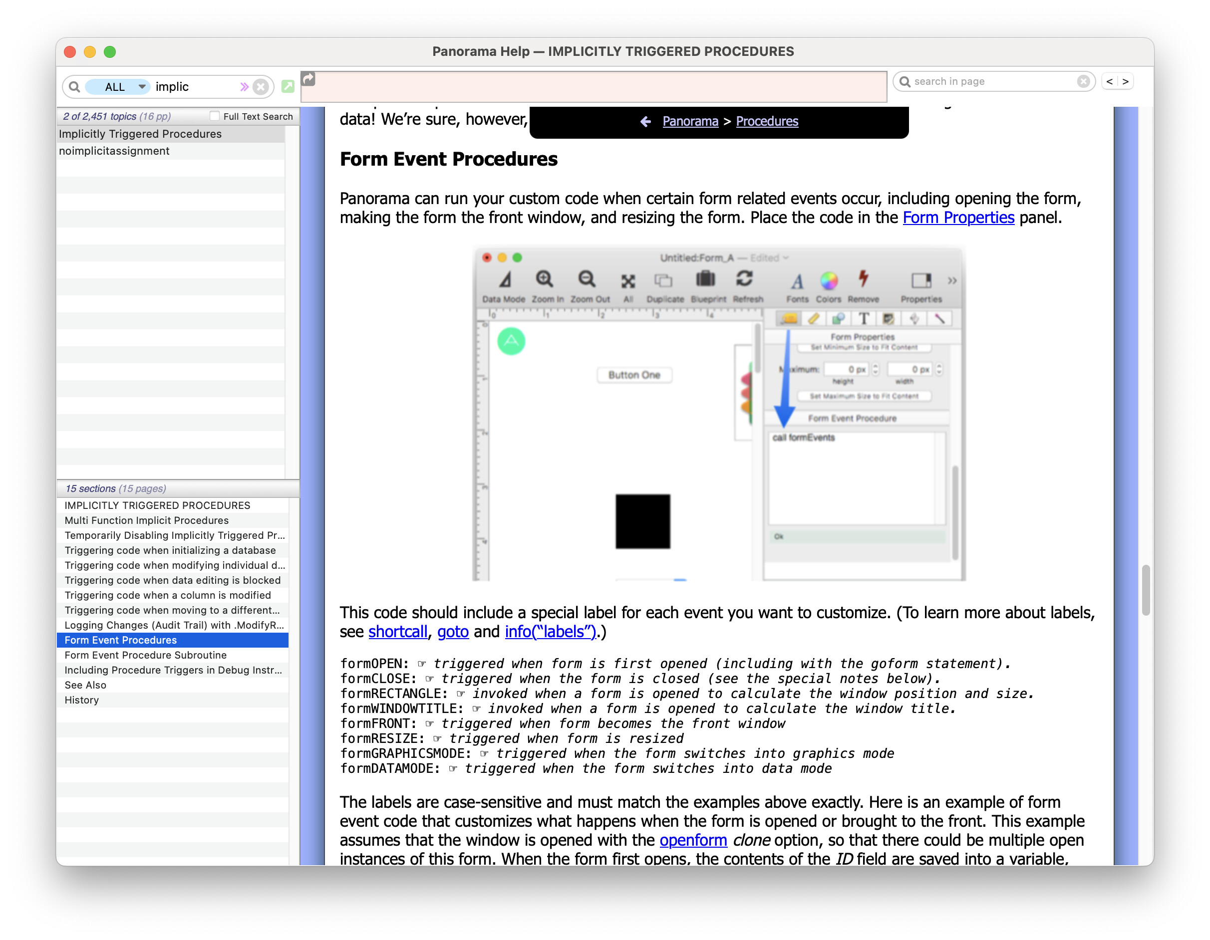

This is incorrect behavior, and I’ll look into fixing it. In the meantime, there is a hack to fix this behavior. If you run this code on a form, pressing the Return key on a form will just beep.
definehotkeys "windowglobal", "RETURN", |||
zlogalways info("activeobjectid")
if info("activeobjectid")<>0
    closeactiveobject
else
    beep
I would suggest that you set up this code to run automatically when the form opens, as described here:

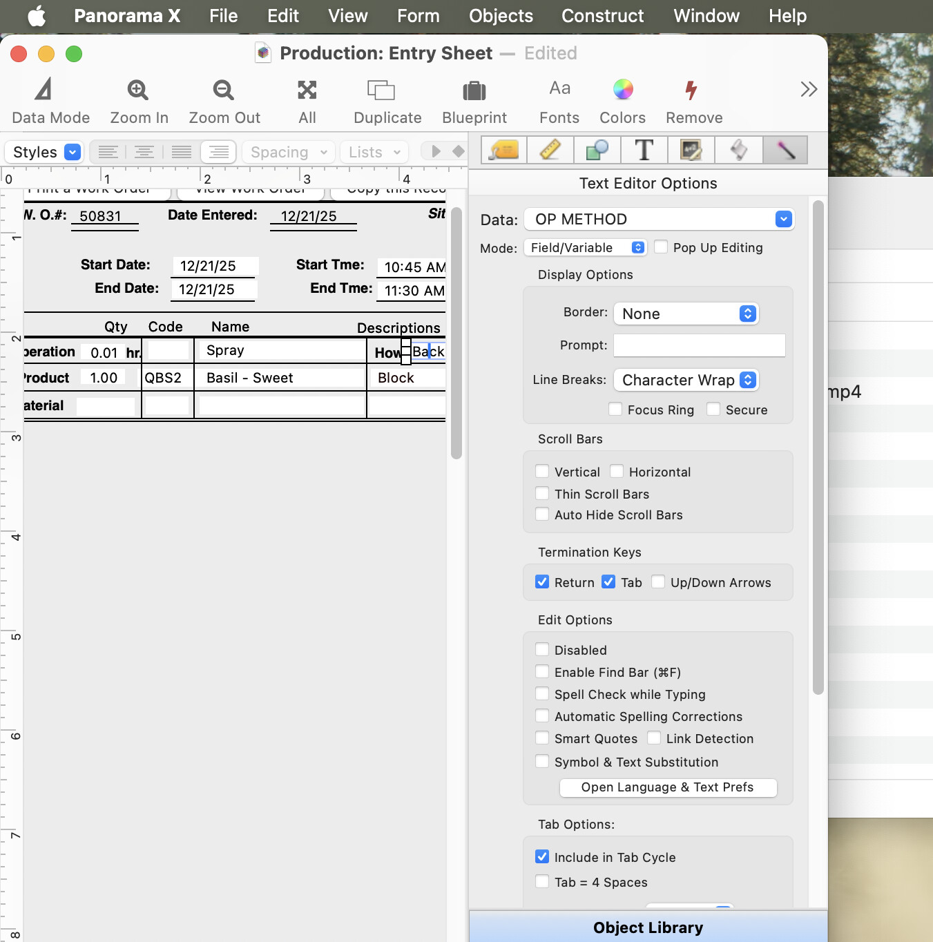

All of the Text Editor objects that were shown in the movie that I sent this morning did have the Return key set to terminate the editing. You can verify that as I sent you the db as well as the movie.
More importantly, I did move from object to object via the Tab key. Listen to the movie and it will be clear that when the entry was made in the Text Editor object and the termination was made, the insertion point was immediately in the next object. There was no addition movement of the mouse cursor to the next object because the insertion point was already there.
This gif does not have sound but it is clear that there is no Return key involved. Only the Tab key. If the Return key was used, and if I had to manually move to the next object, you would see the cursor move to the next object so that a click could be made there. There is no mouse cursor moving to the next object.

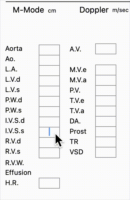

Multiple Cursors
Robert sent me the database from his last post so I was able to try it.
The fundamental problem is that there appears to be a bug in Apple’s code if the text doesn’t fit in the box. If it doesn’t fit, the blinking will persist even when the editor loses focus. In the previous example this happened by pressing the Return key. In this second example the problem is that these fields have a numeric pattern of #.##. So when you enter 0.2, the actual displayed value is 0.20. However, the field isn’t quite wide enough to display that, so the 0 on the end is wrapping down to the next line. Voila - the cursor keeps blinking.
I changed the font size from 12 to 10 and the problem went away.
So if you encounter this problem you either need to make the box wider or make the font smaller. Or you could change the pattern to #.#. Of course the ideal solution would be if Apple fixed the bug, but I wouldn’t hold my breath on that one.
Update. I tried changing the font size back to 12 and changed Line Breaks from Word Wrap to Don’t Wrap, and that also seemed to work. So that’s another option you can try. However in that case it seems like the Center option doesn’t work.

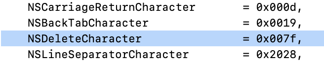

The Delete key also adds a white character [chr(127), not chr(8)] when used to open a text editor.
That’s because internally, the delete key is defined as:
0x7F hex is the same as chr(127) (decimal).

I thought that the Delete key is represented by chr(8) and the Backspace key by chr(127).
I never knew that the Delete key opens a text editor just like the Return key until I experimented with the functionality of special keys in input range options.
That is great! It works really well. You can even add two tab characters within the double quotes.
No tabs should be used in fields, but they can be used in variables for any reason.
ASCII 8 (BS) and ASCII 127 (DEL) have been the backspace and delete characters respectively ever since the 1960s. However, in the past some systems have used a key generating code 127 to delete backwards, which confuses things somewhat.
Herte is another screen shot showing the fake insertion point flashing in the graphics mode with Return and Tab set to terminate data entry.
Try widening the Text Editor Object. The cursor should go away if more width is allotted to the object.
