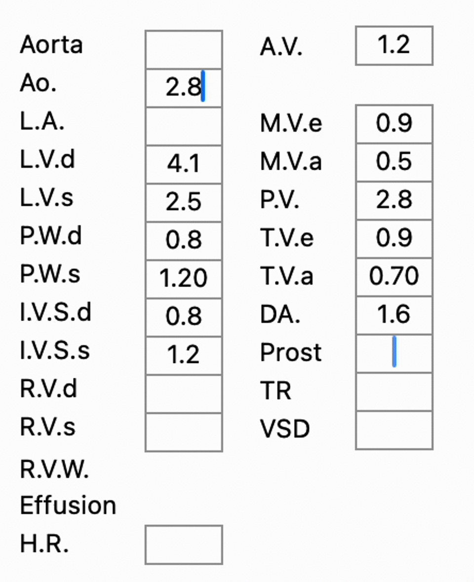

CleanShot 2024-02-22 at 15.05.48@2x
2 Blinking cursors
See ‘Reference Fig:’ box and ‘Page’ box.

I can’t imagine how this could happen. I would like to investigate this further, to do that I will need a copy of the database, and an exact description of how you got it into this state. What happens if you press a key at this point? Does it go into Reference Fig, Page, or neither?

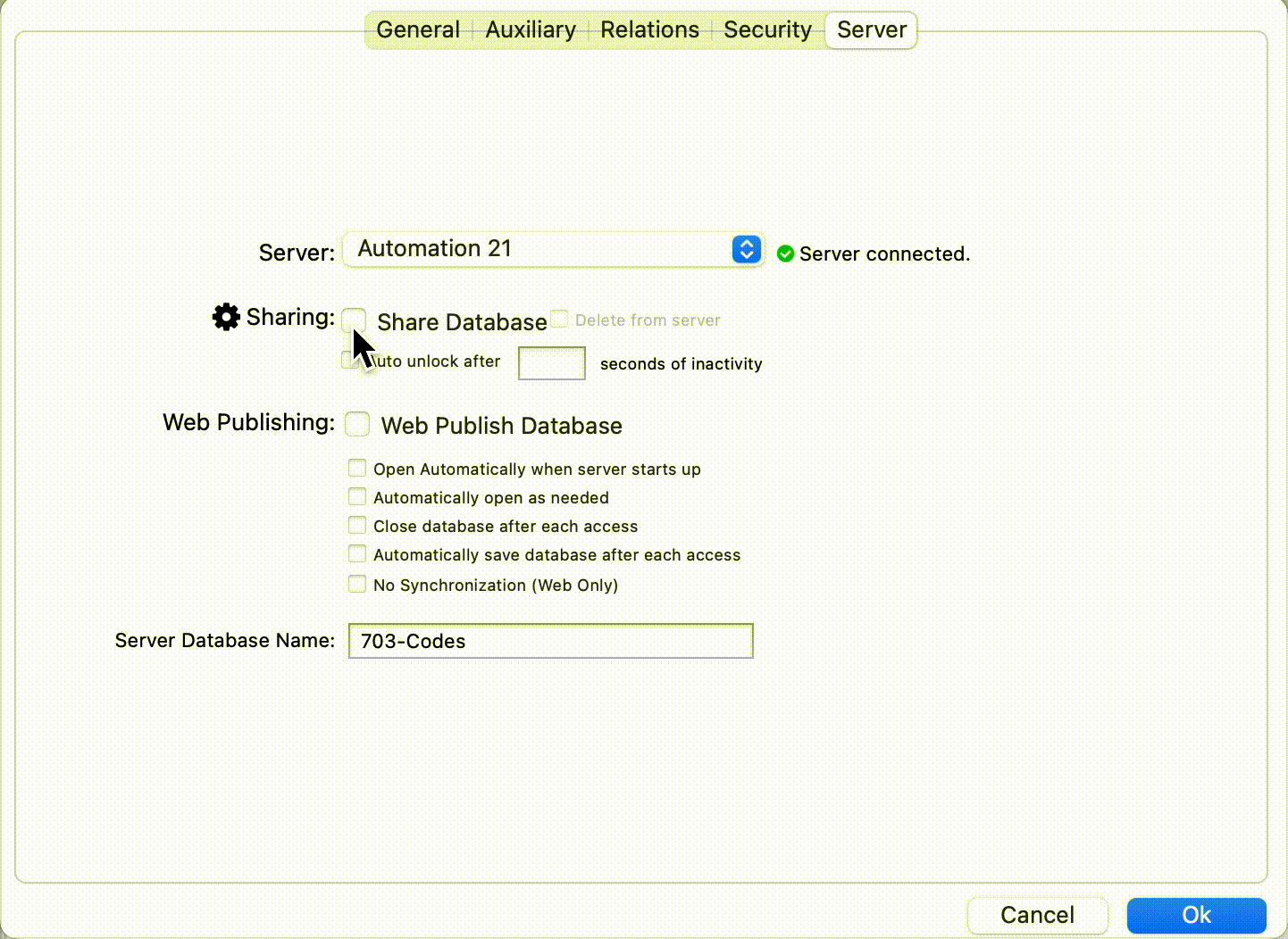

Can anyone else duplicate this blinking cursor in the first Text Editor box?
Panorama Multiple Cursors
As I told Robert in a private email, I only get one blinking cursor. As soon as I click in the Server Database Name the blinking in the Auto Unlock field stops.

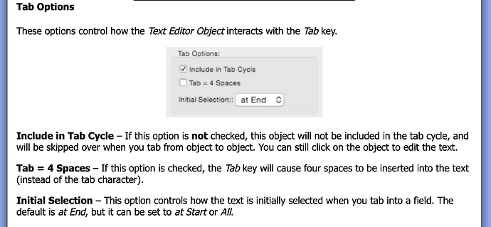

I just verified that if you set the Initial Selection option to at End then pressing the Return key does NOT delete the contents of the field.
The tab key does not close the editor, and the cursor continues to blink even after it is closed by clicking outside the box.
Except for the initial selection of “All,” the Return key does not delete the contents, but it adds a carriage return. This behavior is not problematic for multiple-lined editors, as the carriage return is visible. However, it causes issues for single-lined editors. For the initial selection of “at End,” the cursor appears to blink normally, but the Return key has already added a carriage return. Unless the editor is tall enough to display multiple lines or a vertical scroll bar is enabled, the cursor cannot move down, resulting in the cursor remaining in the first line. Consequently, any keys entered at this point are hidden in the second line. Conversely, for the initial selection of “at Start,” the contents appear to be removed, but they are actually hidden in the second line.
Are saying that you can duplicate the continued blinking of a cursor in a Text Editor box after moving on to another object?
Yes! It is not just the tab key, but also the return key does the same. Looks like no termination keys are checked for the editor, so both the return and tab keys are entered in the editor causing the cursor blinking even after the editor is closed. Looks like inactive editors also display blinking cursors when content cannot be fit, and word wrap or character wrap is enabled.
