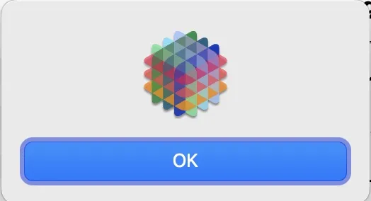

I then restarted Panorama and using Info(“DialogTrigger”) now responds with a dialog with no info, just the OK button.

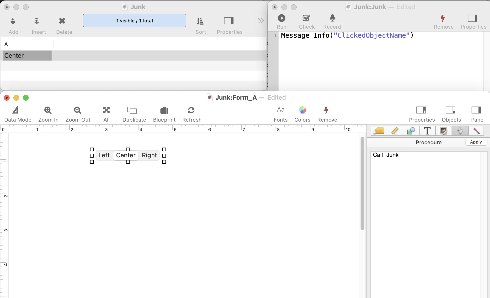

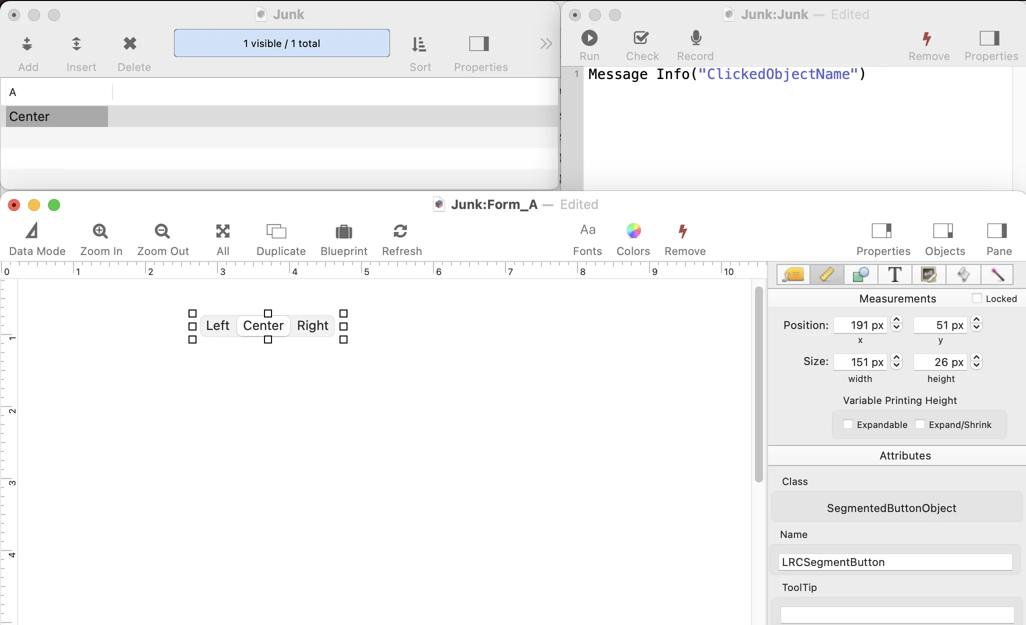

I created a Segment Button and give it a name 'LRCSegmentButton"
I assign the procedure “Junk” to be run upon pressing the button.

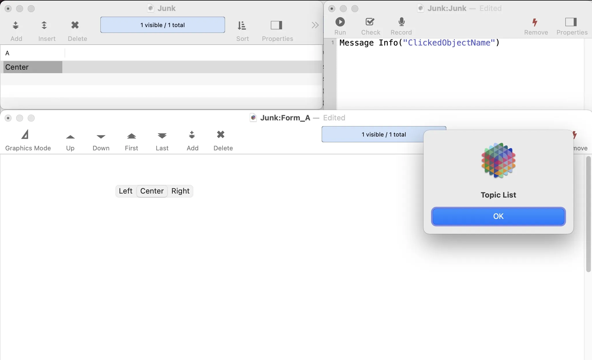

The result of pressing the button is ‘Topic List’. This sounds like something coming from the Help system of Panorama as it was not my text.

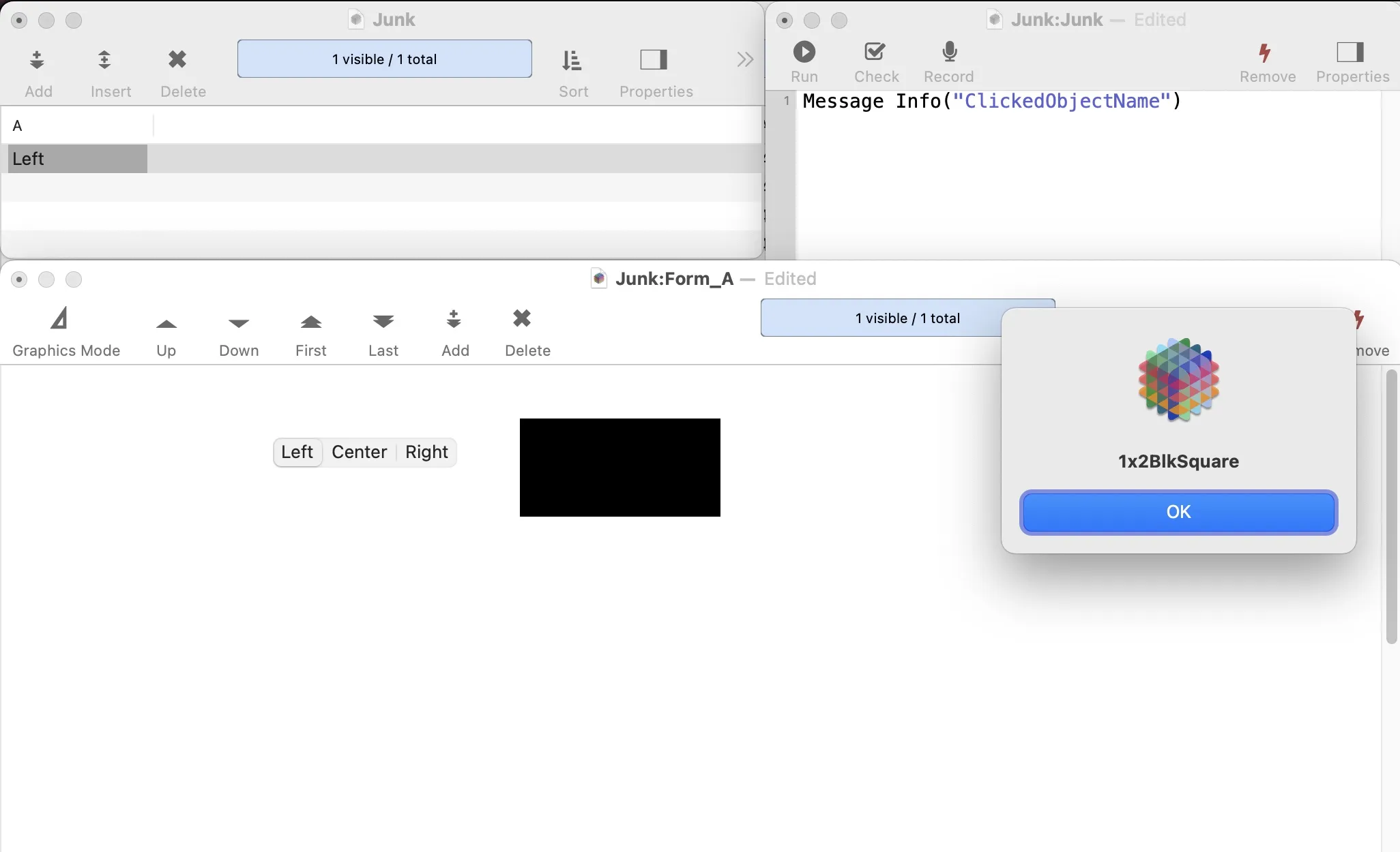

After first posting this, I then added a ~1x2 rectangle. I named it 1x2BlkSquare with its procedure being the same ‘Junk’. I clicked on it, and it returned 1x2BlkSquare. But then when I clicked on the segmented buttons, they too responded with 1x2BlkSquare. Each object responds with the same 1x2BlkSquare response.
Evidently because a Segmented Button returns the name of the button pressed to the field or variable that is linked to it it does not bother to trigger the Info(“ClickedObjectName”).
But if I had several segmented buttons that each had a Left Right Center, that would not be good. I am sure that it should have triggered the “ClickedObjectName”. Checking to see if a reinstall is in order.

As for the ‘Topic List’, perhaps there was something in the past. Can’t say for sure.
That is triggered when you click on an item in the topic list of the Help file.

Dang. Now we are back to inconsistency. I just started up my ‘Junk’ test file again with the segmented button and it gave me the ‘no text’ dialog with only the Panorama OK button.

First of all, you’ve discovered a bug in Segmented Buttons. When clicked, they should set up the underlying data for the info(“clickedobjectid”) and info(“clickedobjectname”) functions, but they don’t. So these functions will return the results for whatever object was pressed previously (if any). This bug will be fixed in the next release.
