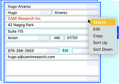

Here’s what I’ve implemented: next to each Text Editor Object in my forms, there’s a semi-transparent button.
  • Single click: instantly opens the Search dialog for the associated TEO field.
  • Double click: opens a popup menu with options for Search, Copy, Edit, Sort Up, and Sort Down.
Because searching is the most common action—about 90% of the time—the single-click shortcut eliminates extra steps and speeds up workflow. Users can still click directly into the TEO to edit field contents, so no existing functionality is lost.

You are persuading me to use right click to show the menu and single click for immediate search, instead of double clicking.
Two buttons doesn’t always work. There are fields too small for this and I want to ensure consistency.
I had use awesome icons before, specifically a magnifying glass. Using a semi-transparent button allows me to use the entire field length to display actual data, without having to modify my forms for more width. Also the rectangle semi-transparent button offers more clicking area than a squared sized awesome icon, helping with clicking efficiency.
These are the reasons for my madness, and again, I’m glad that Panorama offers this level of customization.
