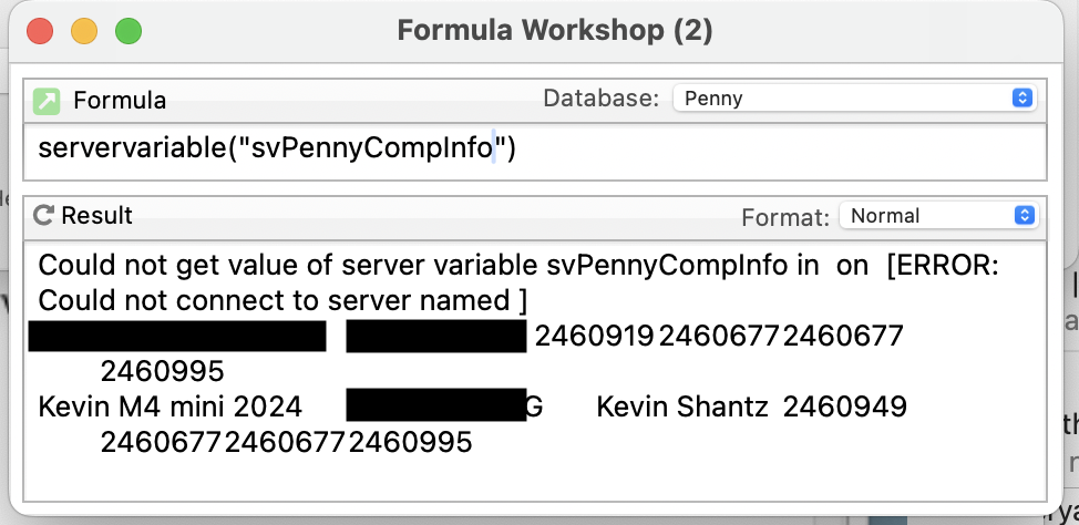

I am getting an error on one of my servervariables.
Could not get value of server variable svPennyCompInfo in on [ERROR: Could not connect to server named ]

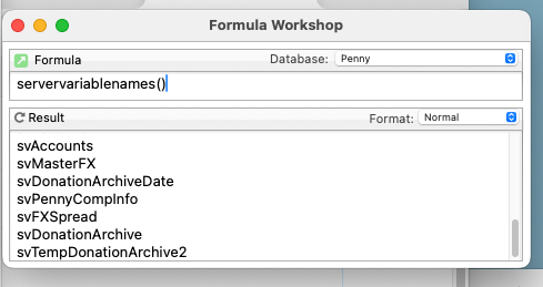

The database is definately talking to the server. the servervariablenames() function returns a complete list and using the servervariable() function on any of the other variables returns an appropriate value.

In the actual code, it does specify the database name. The error I posted was when I tried to access it using the formulaworkshop. So using servervariablenames() it communicates and returns a list as expected.

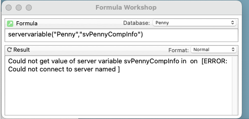

I get the error I posted regardless whether the server is specified or not.
The only file that is open is Penny, a shared database.
The error you are seeing means that the server is never being contacted. Panorama can’t even figure out what the name of the server is. Your problem is entirely on the client side, the server isn’t involved at all.
That is actually not true. The Formula Workshop itself is a single user database. There are also a couple dozen library databases that are open. However, this is just a trivia fact in this case, it is not what is causing your problem.
The only possible cause of this problem is that the database name is wrong. Looking closely at your screenshot, maybe there is an extra space between the quote and the P in Penny? Thought it does also look like there is an extra space between the " and svPennyCompInfo as well, so maybe that’s just how the font looks.
Nevertheless, there MUST be an error in the database name. That’s the only possible cause of the error you are seeing. Maybe there is an invisible character in your code. Or maybe your filename has an extra space on the end - maybe it’s "Penny " not "Penny". I just double checked - it’s definitely possible to create a file with an extra space on the end, and if you don’t have the Finder settings set up to show file extensions, it would be very easy to not notice this mistake. Since Penny is specified in the Database popup menu in the formula wizard, probably the best bet is to leave off the database name in the formula, then it can’t be mistyped. But I would check for that extra space in the filename.
FYI, most of the code for servervariable( and servervariablenames( is the identical. In fact, the since the error you are getting means that the servervariable( code is aborting early, the part of these functions that is actually running IS exactly identical. So the problem has to be an invalid database parameter that you are passing. If you passed that exact same parameter to servervariablenames(, you would get the same error. But it would have to include the same misspelling, invisible character, or whatever is going in there.
Since your formula is correct, I think you know that the first parameter is the database name, not the server name. But just in case there’s any confusion, I’m going to be pedantic and point this out anyway. Server variables aren’t associated with a server, they are associated with a particular database on the server. Different databases will have different variables. Had you used the server name instead of the database name, that definitely would have caused this problem.

The error message “Could not get value of server variable…” was actually the value, i.e. what was stored in the variable, not an error message about trying to retrieve the value of it. So the servervariable() function was performing exactly as expected and there were no issues with the name.
We were having issues with our server at different points yesterday and apparently the procedure that updates that servervariable at some point failed because the server connection had been broken. What seems strange to me is that Panorama actually recorded the error message to the variable and in so doing deleted the data that was there, rather than simply failing. Perhaps that is not strange but it does call into question the safety of data that is stored in other servervariables. If a temporary break of the server connection can cause data in servervariables to be lost, then backing up the contents of these variables becomes critical. (Presumably restoring a backup of the server version of the database containing the variable would restore them. )
In this case, the contents were not critical.
FYI, this servervariable, svPennyCompInfo contains an array listing the users of our database system, computer name, serial number, the date they last accessed it, versions of certain single users files that are on their computer, etc. Each time a user connects to the main “Penny” database, a procedure runs to see if this user has connected before and if so updates the date last active for their record in the array. If a user is not listed in the array, that info is added. It is still a work in process as I determine what info it is necessary to track.
So because of the corrupt data there were no users listed. Checking the variable this morning showed the info on two users who connected this morning, appended to the bottom with the text of the error still on top.

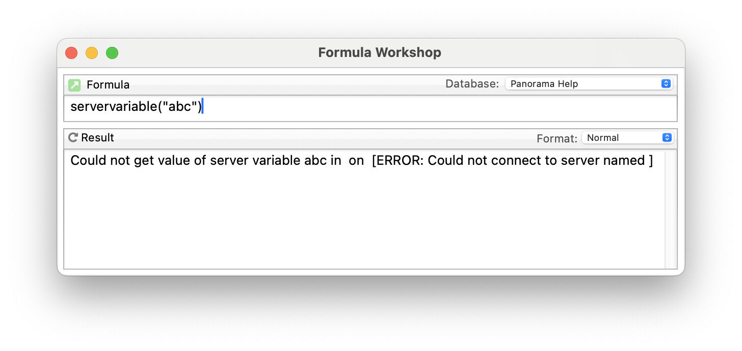

Undoubtably we are getting closer to the mystery here. But your theory that the server connection had been broken doesn’t match the error message that had been returned. The way that error message is written, the connection wasn’t actually broken. That exact error message would not be produced by a broken server connection - it can ONLY be used by trying to use the servervariable( function on a single user database. For example, I was immediately able to duplicate the problem like this:
In this case the error occurs because the specified database, Panorama Help, is a single user database.
If the error was caused by an actual broken connection, the error message would be different - it would include the database name and the server name.
