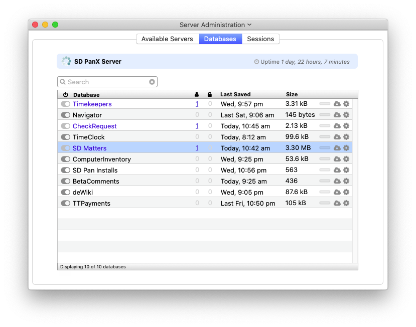

Not sure if this is the right title for this, but the most persistent problem we have seen in testing is the server not closing the connection to a user-it leaves what I am calling a phantom connection. Here are screen shots showing that connections are open for three databases, but there are no sessions open. None of the client computers have Panorama open. This is a problem if I want to update a database, although that is the only problem I specifically know of. The only solution I have found is to stop and start the server.
I have not figured out what causes this condition, but I suspect it can occur if a computer crashes.

I did not use Terminate the session today before making the screen shots. I closed all the client databases and quit Panorama on each one, and was left with the phantom connection. I plan to monitor this more carefully so I can check on the effect of crashes or terminating sessions, or a client losing the connection. My computer can definitely lose the connection since the VPN connection may be closed. I have wondered what happens if a client goes to sleep but haven’t tried to figure it out.
