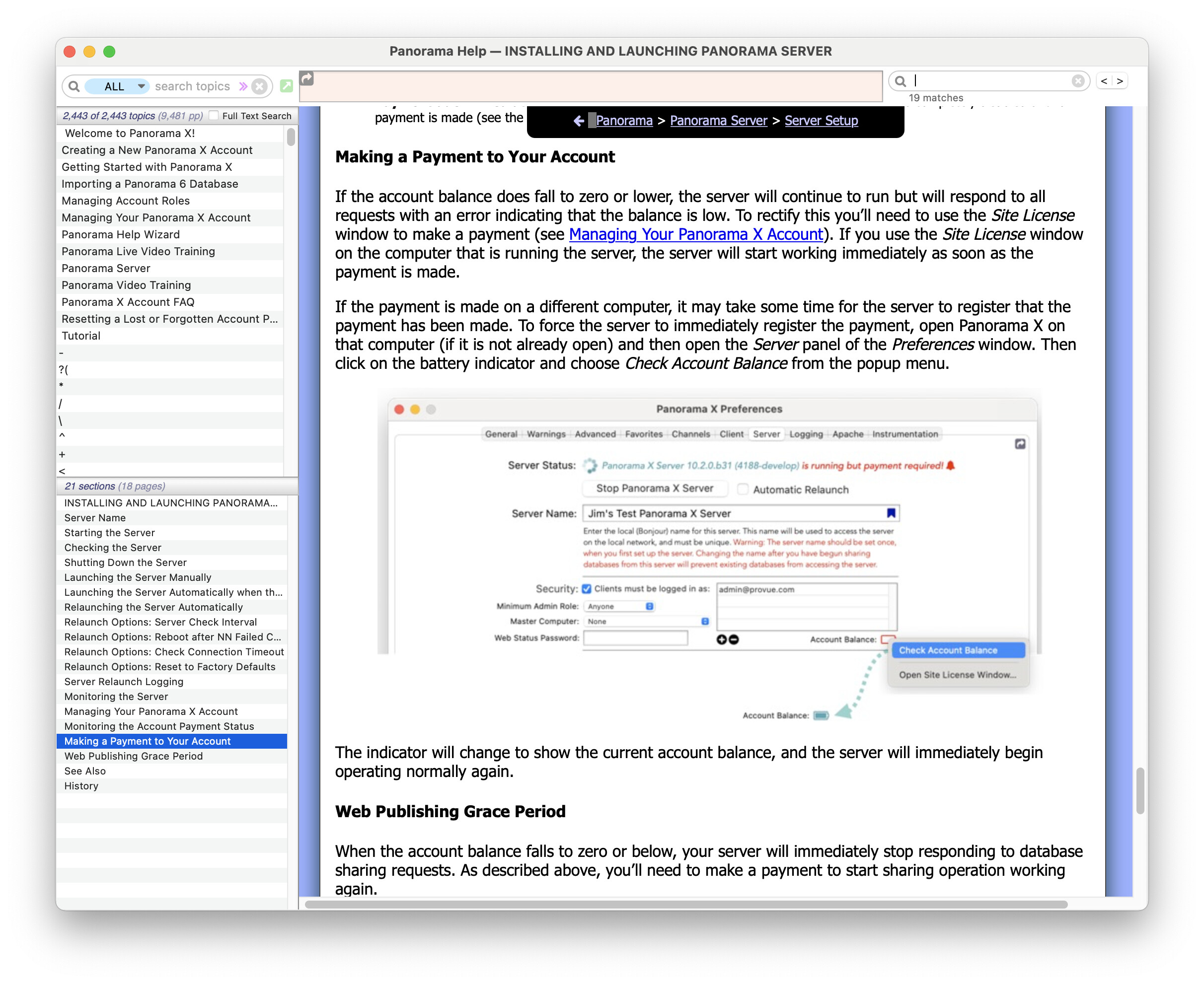

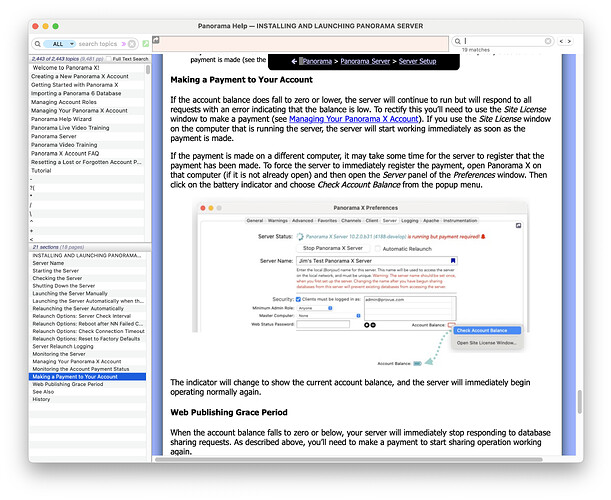

If it does happen again, here is something you can try. If you look down further in the Server preferences panel, you’ll see a battery icon. It should be green, but I imagine it had turned red and showed a low battery level. In any case you can click on this for an a pop-up menu.
CleanShot 2023-07-11 at 16.51.41@2x
If you choose Check Account Balance it will force your server to check with the ProVUE server for your account balance. This was intended for updating the server after you’ve made a payment, but if rebooting the server made it work I think this would also.

If a payment is made on another computer (not the server computer), it can take awhile before the server registers that a payment has been made. That could be the issue here. The help page shows how to make sure that the server has the most up-to-date payment status. It’s likely that you could have followed the procedure described here rather than rebooting the server.
