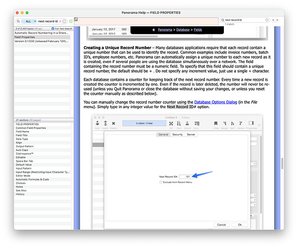

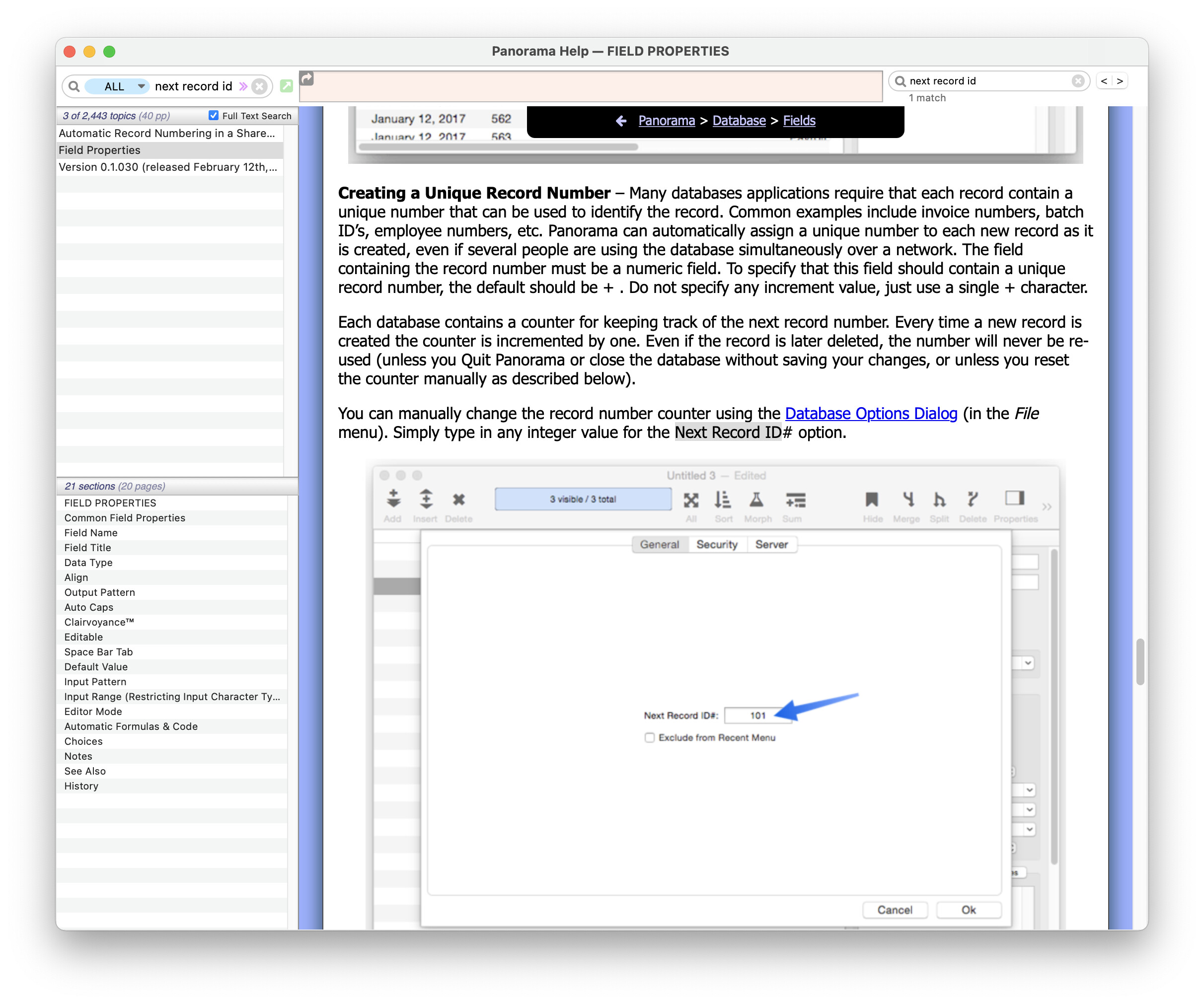

You don’t actually need a RecordNumber field. Instead, you can use Panorama’s built in automatic numbering system. If you put the code below into the .NewRecord procedure it will automatically generate the admissionID for you (I’m assuming your field name is admissionID).

The sequence generated will automatically start with 1, but if you ever need to reset the sequence to start or restart at a different number you can do that using the Database Options dialog.
Thank you! I will study the link on uniqueid!
