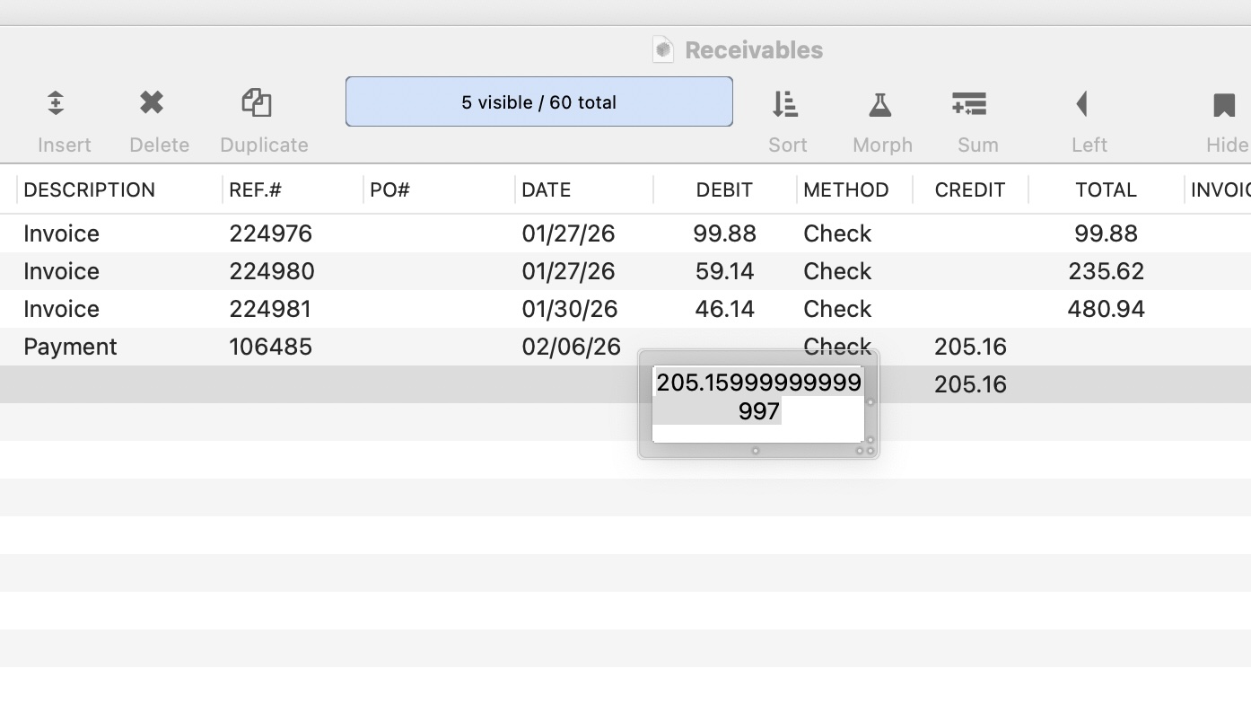

I finally investigated why I get an error message saying the check amount I entered doesn’t equal the total of the invoices paid. How can this happen?

The DEBIT field has an output pattern, #.##, however, these debit amounts are imported by procedure in money format. Adding the round function fixes the error message and the summary record is temporary.

Floating point numbers are stored and manipulated using the IEEE floating point standard, which is built into macOS, and actually built into the processor chip. This format stores the numbers in a binary floating point format (base 2). For whole numbers (integers), this provides exact values. But for fractional values, many decimal fractions cannot be exactly represented in binary floating point format. For example, take the value 59.14. There is NO binary floating point value that corresponds to this decimal fraction. The closest possible binary value is 59.140000000000001. So when you set a floating point value to 59.14 (whether by data entry, importing, via a procedure assignment, it doesn’t matter) what is actually stored is 59.140000000000001. Usually you display a rounded value, so it doesn’t matter. But if you combine multiple values with arithmetic operators, these small deviations can add up a bit. Because of this, it turns out that.
99.88 + 69.14 + 46.14
does NOT exactly equal
205.16
It’s close, but not exact. So when comparing floating point numbers for equality, what you actually have to do is calculate the difference, and then look for a difference below a threshold. If below that threshold, then you can consider the values to be equal.
