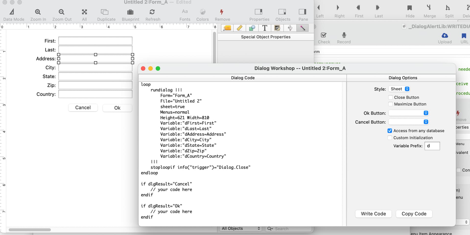

I seem to be wrong quite a bit lately, and I’m wrong again. I did think of this before, and the Dialog Workshop does have code to write the declarations. However, I must not have ever tested it, because it doesn’t quite work. Just a small tweak, and now it does. Well, my copy works, and yours will once the next release comes out.
All you have to do is set up your form with Text Editor objects that have the d prefix on the variable names, for example dFirst, dLast, dAddress, etc. You can do this automatically with the constructor (I suspect you already figured that out).
If the dialog workshop finds Text Editor objects that match this pattern, it will automatically write the variable declarations for those objects. It doesn’t do this for all fields - only the fields that actually appear in your form.
While I was at it, I also made it so that you can change the prefix if you want, you don’t have to use d.

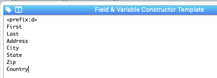

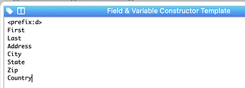

Here’s an example constructor template:
And here’s the form and the automatically generated dialog code:
For now, you can just use your procedure or the formula I posted earlier today.
