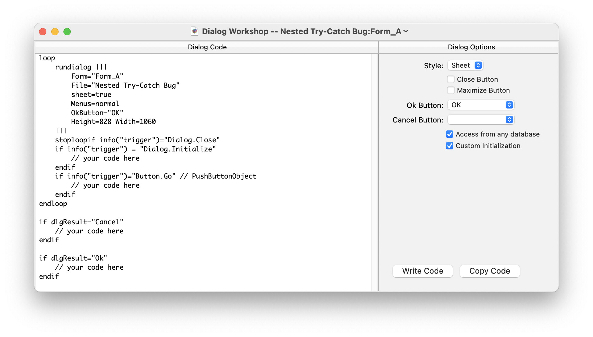

It did that because the standard spelling of that button (according to Apple) is Ok, not OK. Since you used a non-standard spelling, the Dialog Workshop did not recognize that it actually was the Ok button. You could have gotten it to generate the code you want by using the Ok Button popup menu in the Dialog Options section, as I’ve done here.
My dialog has three buttons, OK, Cancel and Go. The Cancel button is automatically recognized because I used the standard name for that button. If I had picked a non-standard name for the Cancel button I would have needed to specify that name in the Dialog Options panel of the Dialog Workshop.
Notice that there is no code for the Ok and Cancel buttons. These buttons are normally handled automatically, you don’t need to supply any code. You only need to supply code if you want to do some extra validation before Panorama actually performs the Ok or Cancel operation. If you do want that, you look for the triggers Dialog.OK or Dialog.Cancel – NO MATTER WHAT THE BUTTON TITLES ACTUALLY ARE. There are examples of this in the rundialog help page.

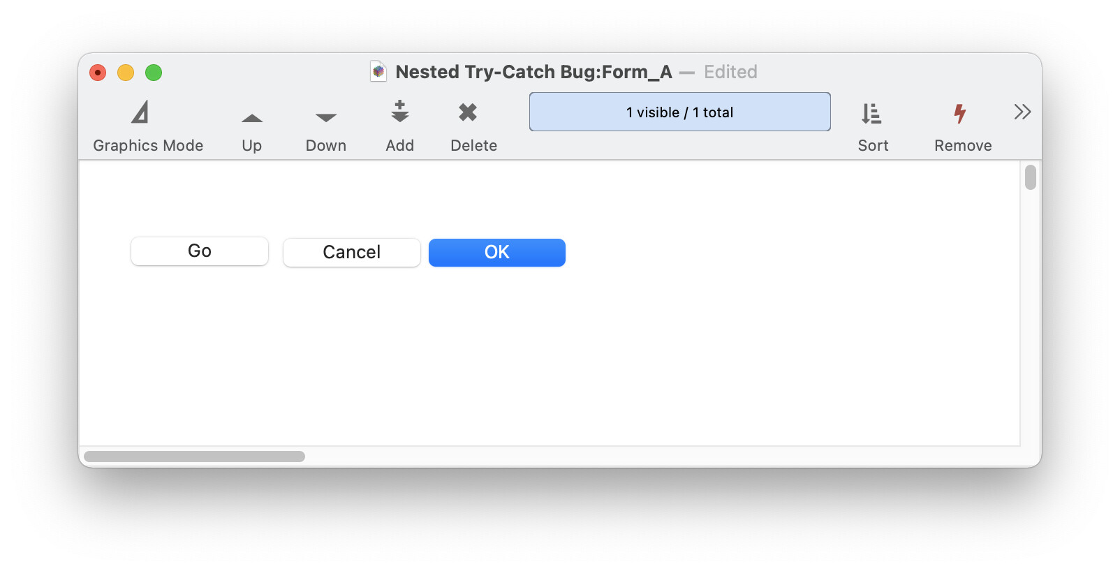

First, you create your form. Be sure that your OK and Cancel buttons contain the code resume "". Resize the window to the size you want it to display as a dialog (you’ll have to adjust this later, but it will be faster if you get the size close).
Leave the form open, then create the procedure (or you can use an existing procedure). Open the Dialog Workshop. You’ll see that the code is already written. If your OK button is not named OK, then choose the button from the popup menu. You can also choose whether you want your dialog to be a sheet or a standalone dialog. When you make any changes in the Options are the code will immediately revise to reflect your choices. There is also a Write Code button, but it’s not needed.
Now you can copy the code into your procedure. Either press the Copy Code button, or simply select the text and copy it. Either way, paste it into the procedure window. It’s just code like any other code. You could also paste it straight into the code section of a graphic object, but I usually don’t do that.
Now you can simply run the dialog to test it. Note that you can leave the original form window open while you do that, and you can leave the Workshop open also.
If the dialog size is off such that the Cancel button isn’t visible, just press the ESC key to close the dialog. Usually you need to tweak the dimensions of the dialog in the code to get the size just right - it usually takes 3 or 4 iterations. Voila! Your dialog is ready.

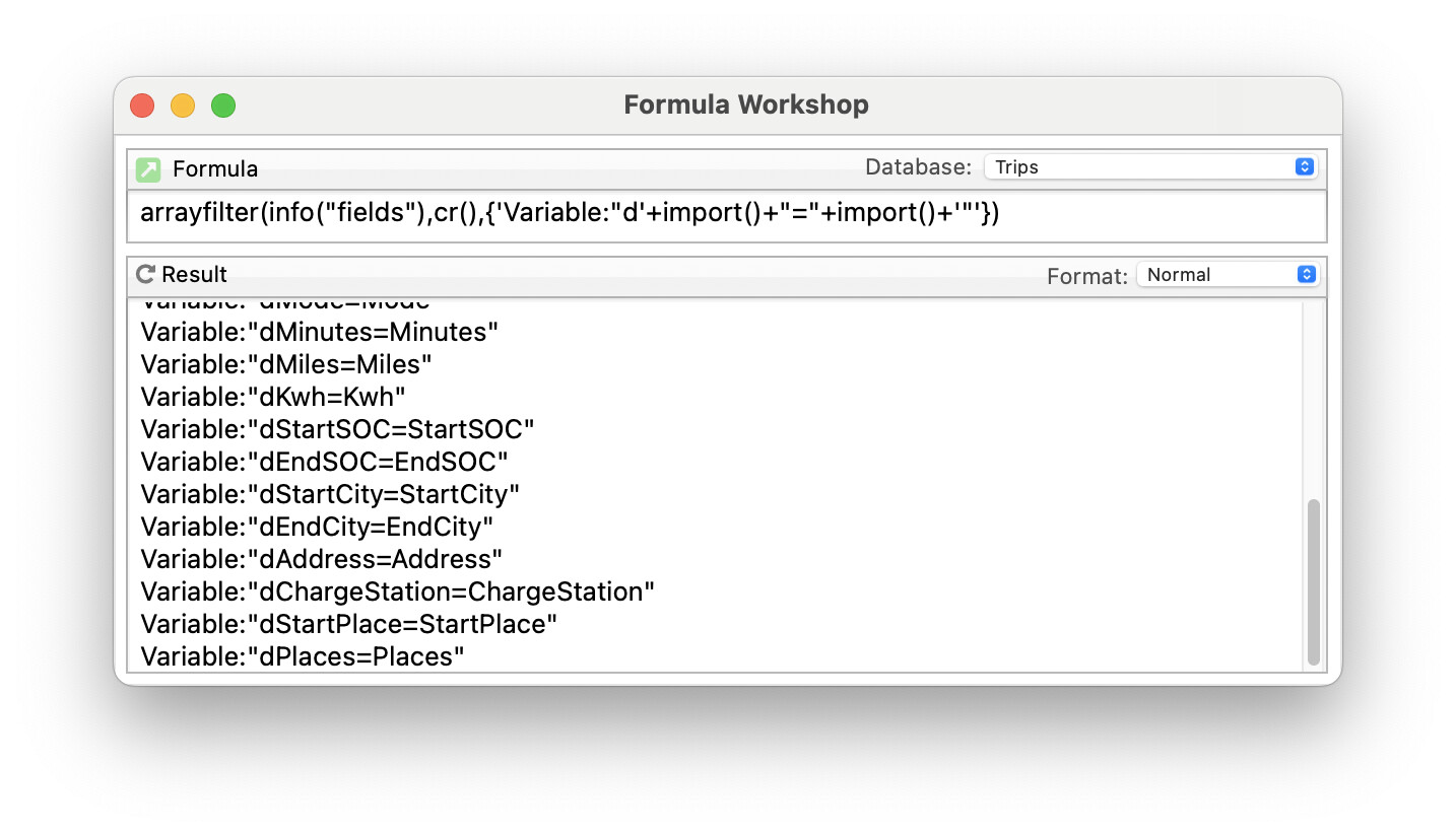

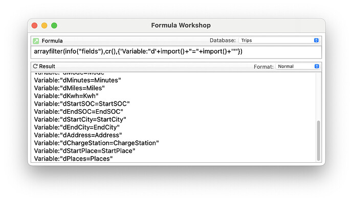

Now that you’ve posted this code, it jogged my memory. Your code is fine, but you could just run this formula in the Formula Wizard.
arrayfilter(info("fields"),cr(),{'Variable:"d'+import()+"="+import()+'"'})
Here’s what it looks like in the wizard, you can copy the result out of the wizard.
