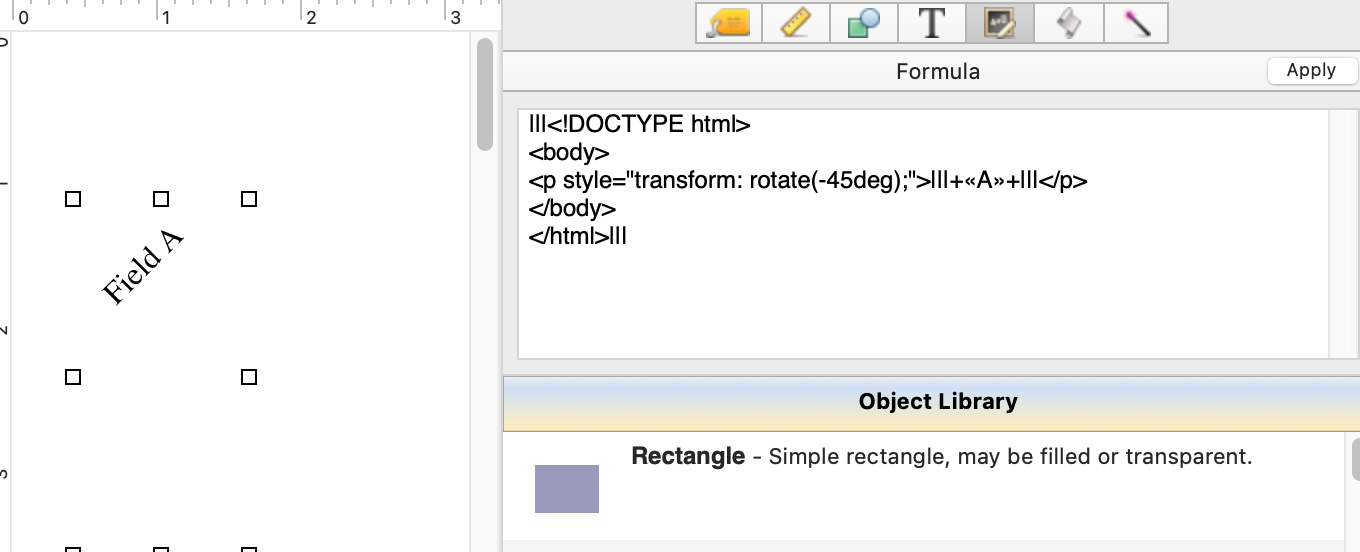

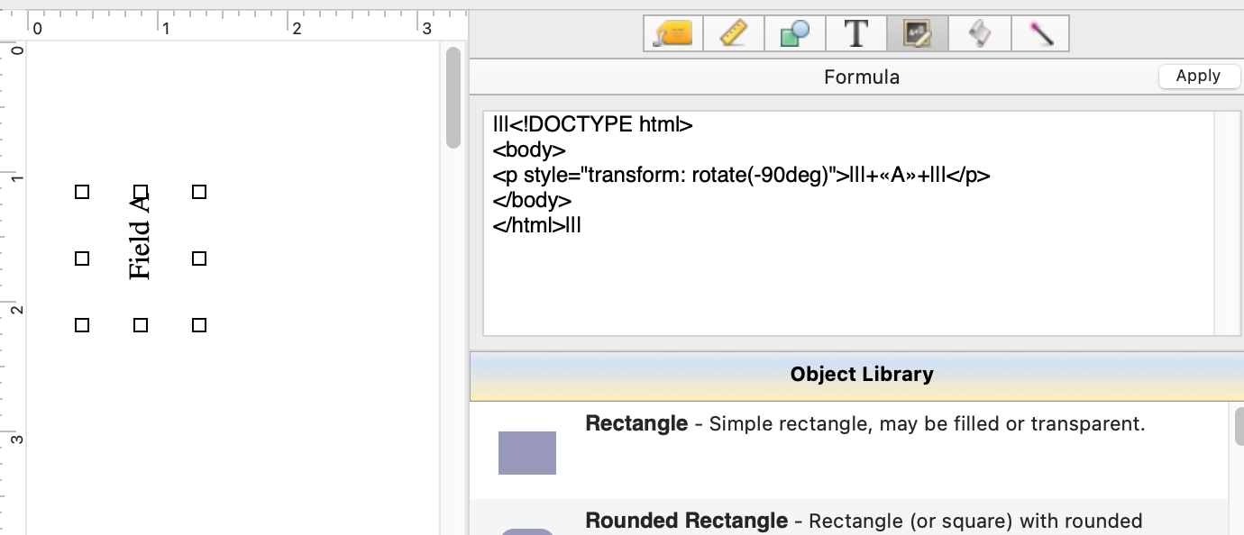

This is all you need for the web browser object, at it’s minimum.
You might need to play a bit with CSS margin adjustments.
Of course, you can set any desirable angle as well:

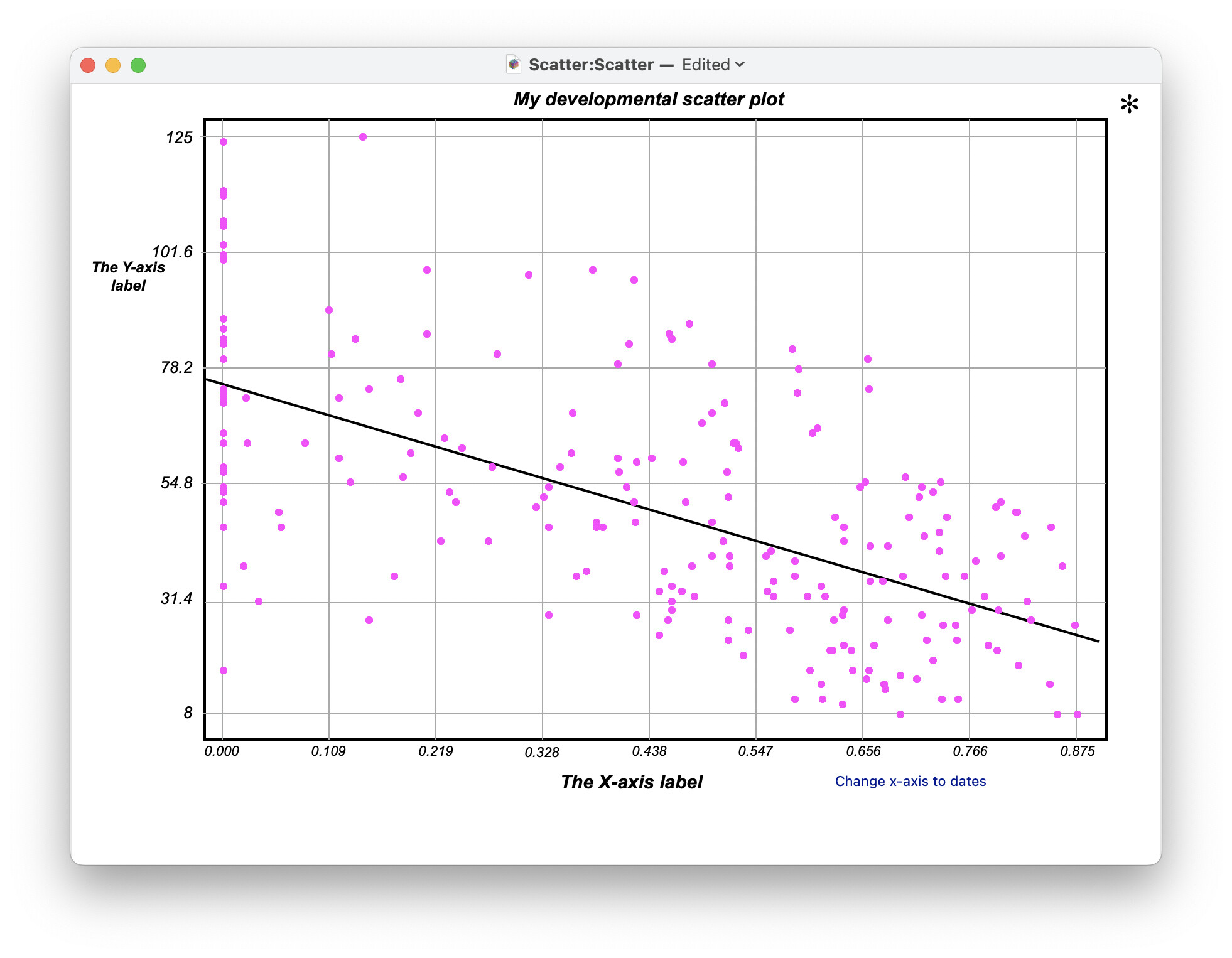

Wow, I had no idea that this question would generate so much discussion. Thanks to everyone for commenting. In case anyone is wondering, which I am sure you are not, I have been working on a procedure to duplicate or surpass the Excel feature of creating scatter plots. Here is the result so far, but this is still a work in progress. If anyone would like a copy of the code, please let me know.
Your scatter chart looks excellent. Is it built in HTML? Perhaps using the Plotly.js package? Or are you manipulating Panorama graphics directly?
I created a Pan object (oval) for each data pair, and scaled the data so it just fit in the chart rectangle. I started with an array of ordered pairs and looped through the array, one oval for each data pair.
That’s a nice demonstration of what’s possible with Panorama’s graphic capabilities. How long does it take to draw that chart?
You could even set up tooltips for each object so that if you hovered the mouse over a point it would show additional information, perhaps the values and/or a label.
This plot with 106 point took about five seconds. I did add a tool tip to show the x and y values when hovering.
I’ll bet it’s pretty cool to watch it draw the plot ![]()

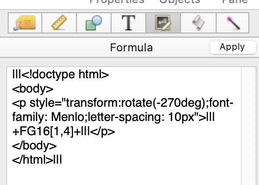

Hugo - I’ve been looking for something like this since Pan X debuted. I’ve been able to get the text rotated to -270 degrees, but I am not able to figure out how to space the numerals to fit into the boxes on my bank deposit slips nor how to select the font and size. If I make separate web browser objects for each numeral, as I used to do with text displays in Pan 6, they won’t tile and keep displaying the text. The topmost covers the one underneath as I bring them close together and I can’t shrink the size of the object or I end up with scroll bars showing up.
I’m trying to get something like 1 2 5 0 0 to be spaced exactly to fit into the form’s boxes. Do you have any tips on how to do that?
Took a while, but I got it. This tip should solve a puzzle for me. Thanks for posting about html and CSS tags
Scott, I’m glad you figured out one way of accomplishing this.
I was not aware of the letter-spacing style. That is very convenient. Thank you!
