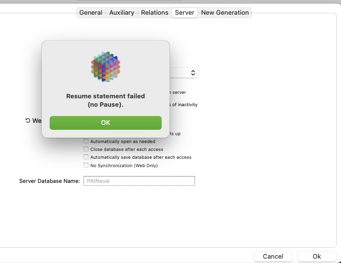

It’s not uncommon when working in a database to encounter a Resume Statement failed error when in one or another of Panorama’s settings windows…
The biggest problem with them is that there’s no way out except for a Force Quit. I can click OK to close the Error Dialog, but a click on either OK or Cancel in the settings window, in this case Database Options, brings up the error dialog again. I can use the tabs to change to General, Relations, etc, but there too a click on OK or Cancel gets the error.
The Escape key doesn’t get me out of the window either. In this instance I’m told I’m not authorized although I am.
I can also activate and work in other files or settings windows. It’s just the one that is “stuck” and only a Force Quit resolves it.

During development, I have occasionally seen this alert, but not for a long time. I have always been able to get out of it by pressing the ESC key.
That is all what I would expect. The code that runs the dialog has halted, it’s not going to come back. But pressing the ESC key should close the dialog even though the dialog code is no longer running - it always does so for me.
It sounds like it has somehow forgotten the hotkey that was set up when the dialog opens, so the ESC key is reverting to the default behavior of switching to graphics mode - which you are not allowed to do in the Database Options window. I don’t know why the hotkey wouldn’t work, as I said, it always works for me.
There is another hotkey for closing the dialog - Command-W. Though if ESC doesn’t work, maybe that won’t either. But you should try it.
I thought that there was another hotkey FUNCTION-ESCAPE that would abort any dialog. Right now I can’t find that in the source code, so maybe I imagined it? But you should also try that.

Today I received this same “Resume statement failed” error message, after making changes to the Field Arrangement and Data Types of a shared database. This is the first time I have seen this message, after years of working with shared databases.
