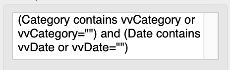

I have a button that calls a procedure to select all and a button to that calls a procedure to select a specific category. These work fine (thanks to kind people on this forum). I have attempted to make a button that will call a procedure to filter by a specific year. I can’t make this work. This is the Query box on the Text List Options:

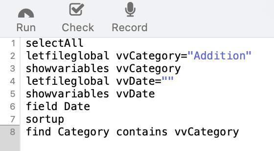

This is the procedure for filtering by Category (Addition, as an example).

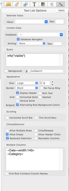

Put info(“visible”) in the Query box for your Text List.
Thank you. I added this to the query box for the text list object. This is what’s in the query box:
info(“visible”) and (Category contains vvCategory or vvCategory=“”) and (Date contains vvDate or vvDate=“”)
Is this correct? Now what?
Seems to be correct, so now just run your procedure and it should only display currently selected records.

neonate, I noticed you used a FIND statement instead of a SELECT command at the bottom of your procedure step. Are you sure “find”, rather than “select”, is what you want?

Find seems to be working. The procedure above shows all of the records with Category = Addition, and selects the first record.
Thanks for pointing this out. I’ve never tried that but will so.

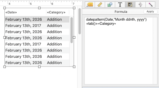

Next is the Text List with the Formula panel.
And now the Options pane for the Text List.

Actually, the first question is whether or not you are using the Database Navigator option is turned on. Text Lists behave completely differently depending on whether or not this option is enabled.
No, it’s not. Paul is right, the find statement is not going to have any effect. If the Database Navigator option is enabled, then the select can work. But I’m thinking maybe the Database Navigator option is off, and that’s why you think the find statement is working.
The first thing you need to decide is whether you want this Text List to mirror the data sheet. If so, then you need the Database Navigator option to be enabled. But it sounds like you want the Text List to be independent of the data sheet, in which case Database Navigator should be off.
If the Database Navigator option is off, then selections in the data sheet don’t affect the Text List. In that situation, the Text List is controlled by the Query option in the Text List properties. Note that in this situation the procedure recorder that Paul mentioned does not apply.
I suggest slowly and carefully working through the documentation page that discusses how Text List works with a database.
vvDate is a variable. I put that in the procedure (and the query) because I thought I would need. a variable. Now, I don’t believe I need it.
Yes - Database Navigator is enabled.

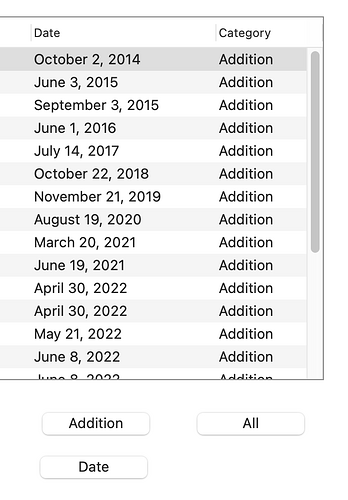

Not sure. I don’t keep the data sheet open, I use one form and buttons to select which records I want to view. Here’s what I see: When I click on the button “All”, the text list shows all 65 records. When I click on the button “Addition” (which uses the query box and the procedure as outlined above), the text list shows the 24 records whose Category is Addition and the first such record is selected. When I looked at the data sheet it shows all 65 records.

Done. Based on the documentation and the discussions above, I have revised my database - I will use info(“visible”) in the TLO Query box and will update my procedures to use “select” instead of “find”. I think it will be better to have the Data Sheet and the TLO on the forms mirror each other. That way, if I do use the Data Sheet view, the procedures will work appropriately there.
