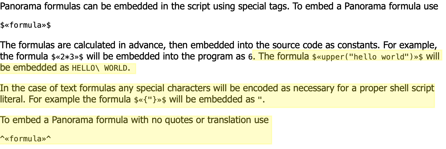

Actually, I think it’s a question of whether the formula contains more than a single parameter. When you enclose the formula in ‘$«»$’, special characters in the result are escaped. That means the spaces between parameters will be escaped.
|||$«FieldValue("",Command)»$|||
is being rendered as
lpstat\ -p
instead of
lpstat -p
Write that as
ShellScript |||^«FieldValue("",Command)»^|||,«Result_From_Terminal»,5
and it should work.

The problem in all of these cases is that a space is being escaped when it shouldn’t.
Instead of
lpstat -p
you are getting
lpstat\ -p
When you don’t want any of the characters produced by the formula to be escaped, you need to surround it with ^«»^ rather than $«»$.
The documentation does have an error in the markdown. Instead of
$«{"}»$ will be embedded as "
it should read
$«{"}»$ will be embedded as \"
