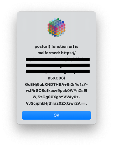

In building a procedure to work with a large incoming post, I’m trying to simulate the post with PostURL(. The URL includes an encrypted identifier which Panorama encrypts and decrypts properly.
But with the encrypted URL, Panorama complains that it’s malformed. After a bit of testing, I found that when the identifier is encrypted, it includes a line break. Removing the line break from the encrypted string eliminates the error from PostURL, but then it has an error when it’s decrypted.
