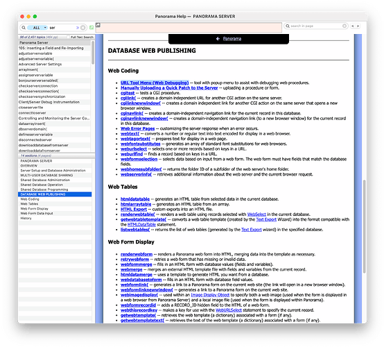

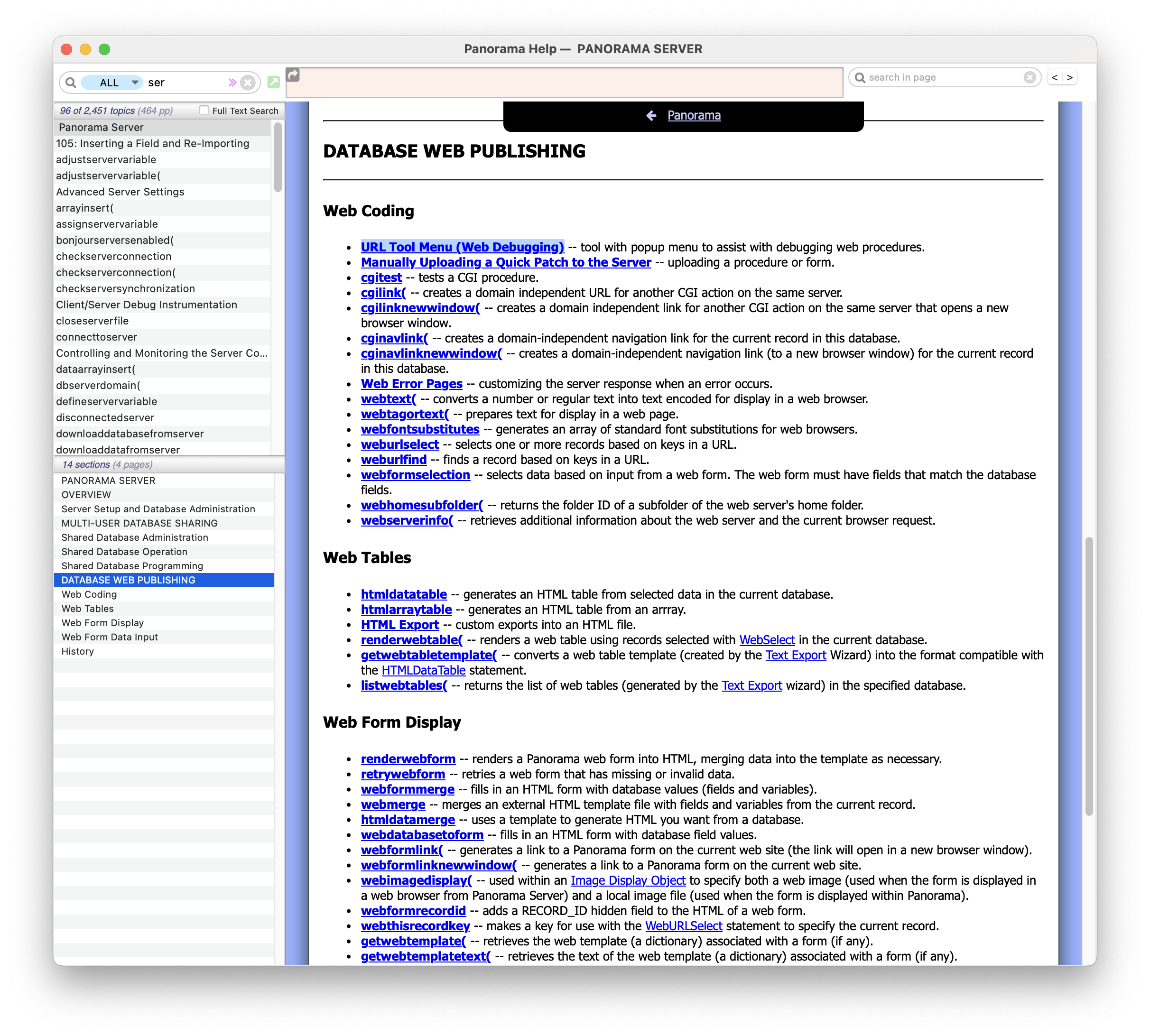

Panorama is extremely capable of what you’re describing. A place for you to start is in the Panorama X Help: Using an External Web Server
There are also numerous threads on this forum worthy of your attention.

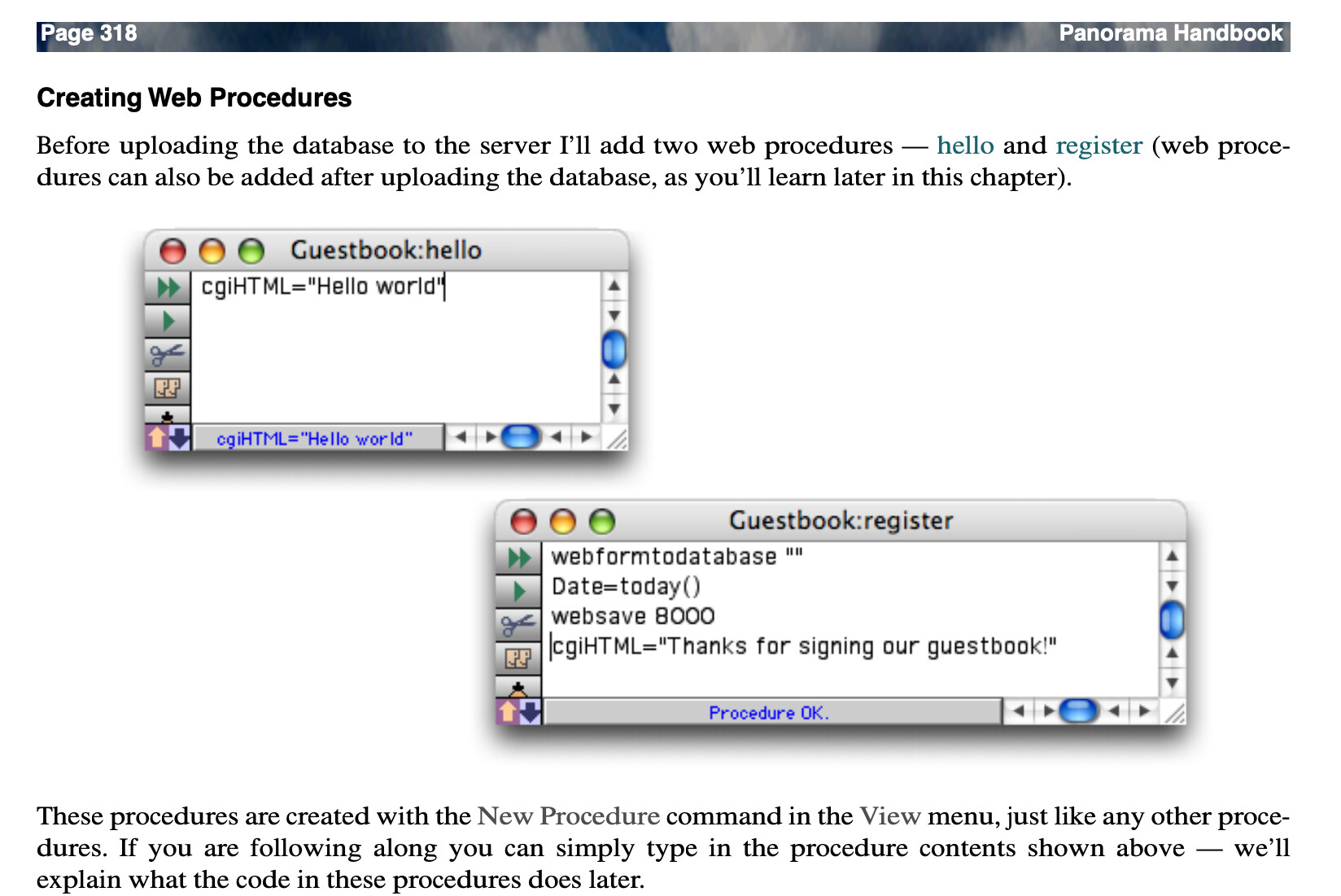

That’s basically the only thing that Panorama X web server does! In its simplest form, you can write a procedure with one line.
cgiHTML = "Hello Wold"

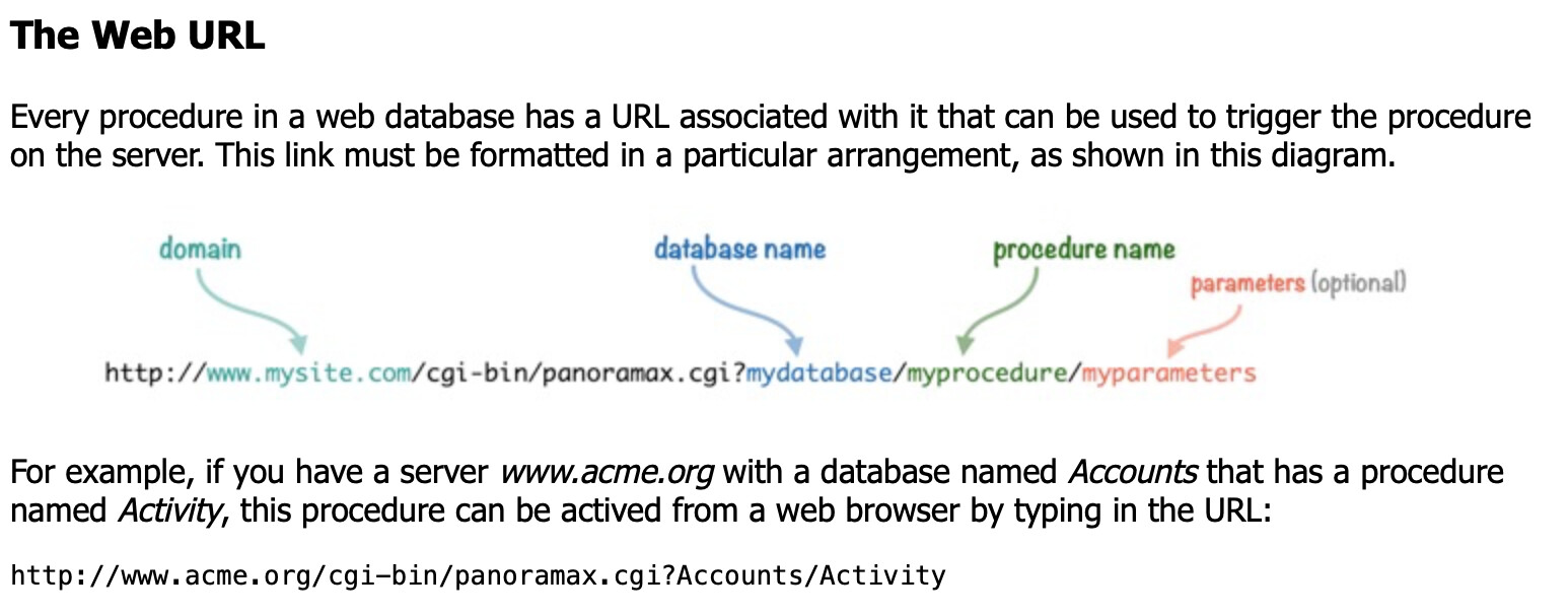

The URL format you propose isn’t quite right - here’s the actual URL format.

There is actually a lot of documentation available for writing web server code (but with some caveats, see below):
I don’t know if you ever used Panorama 6 Web Publishing, but if you did, the code is 99.9% identical between Panorama 6 and X. What is different, however, is the infrastructure, for example uploading code. However, it’s actually much simpler in Panorama X.

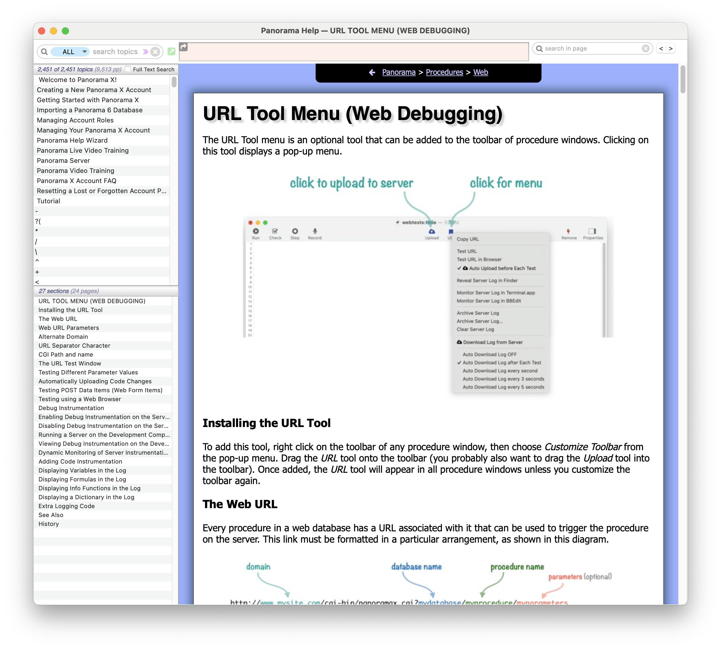

Panorama 6 had a simulator that could allow you to run web code on your client computer. Panorama X doesn’t have this. However, it has a much better system that makes it really easy to debug web code right on the server (and of course it’s easy to run a server on your computer if you want). I’d highly recommend checking out this help page very early in your journey. I’ve used this new tool myself quite a bit and I find that it makes developing and debugging web code nearly as easy as developing “regular” Panorama code.
Although all of the details of Panorama X Server web publishing are documentated, so far there isn’t any tutorial or any kind of an overall roadmap or guide book that will walk you through building a web application from getting started through more complicated applications. For now, you kind of have to piece together the details yourself. Since the code is nearly identical, you may find the Panorama 6 Server documentation quite useful.

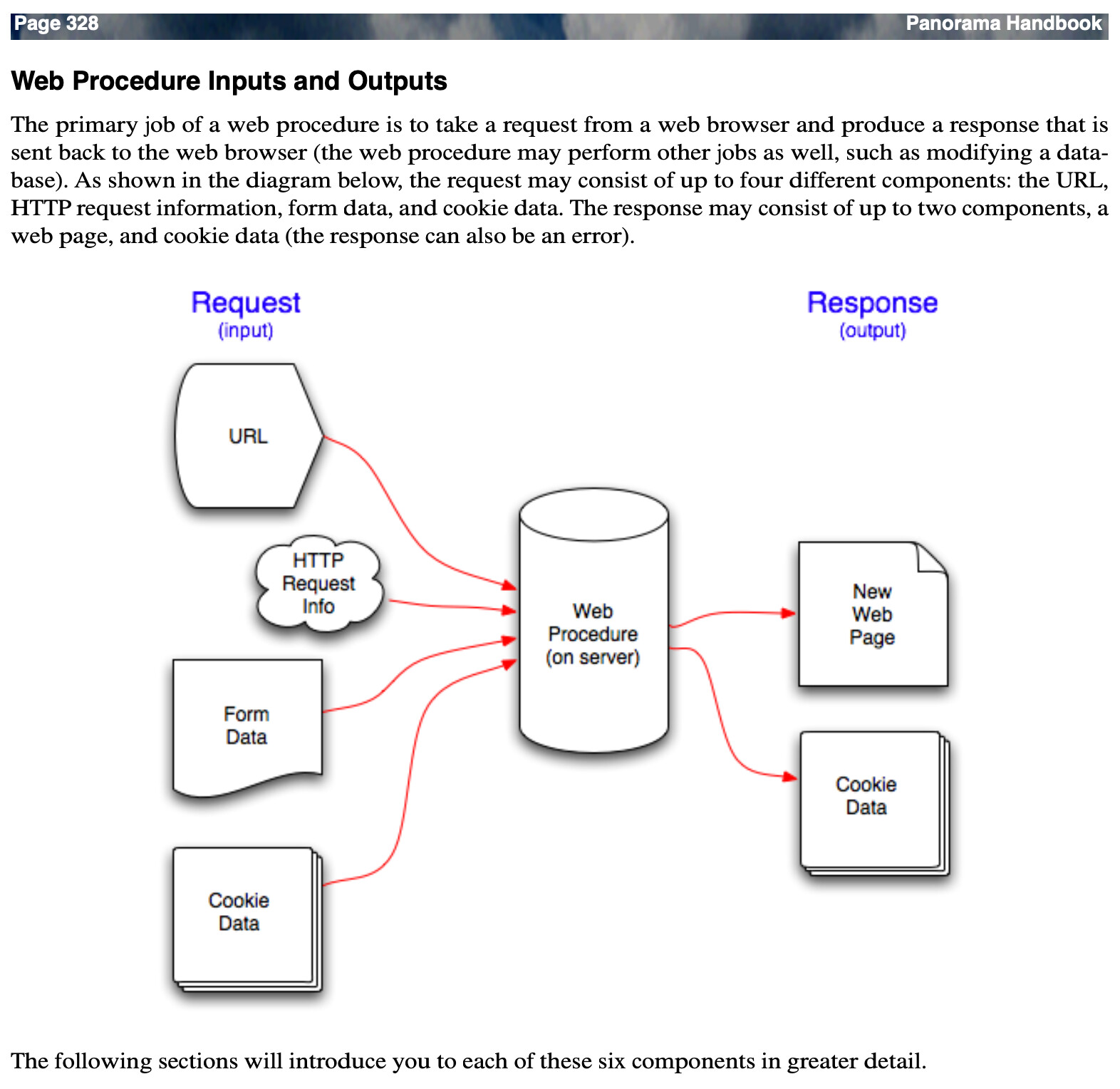

cgiHTML is a global variable. You don’t need to enable it - Panorama X Server sets it up before it calls your code. This is mentioned near the beginning of the Web Programming 101 chapter in the PDF file I mentioned.
However, right after that is a bunch of obsolete information about using the CGI Simulator. So I would skip that and read this instead (I mentioned it earlier).

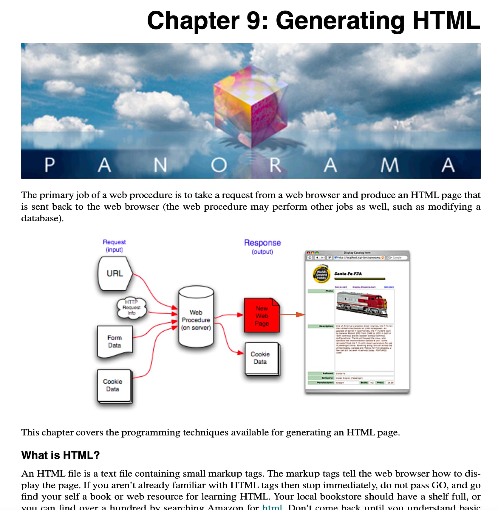

Then you could skip ahead in the PDF to:
Then you could skip ahead to Chapter 9. (In fact, now that I think about it, maybe you could just skip Chapter 8 entirely and go straight to 9. But definitely read the URL Tool Menu page.)
Pretty much everything in Chapters 9 and 10 carries over to Panorama X, and most of Chapter 11 as well. Though for error handling I would recommend using Panorama X’s new try/catch system instead of the web error system described (though that still works).

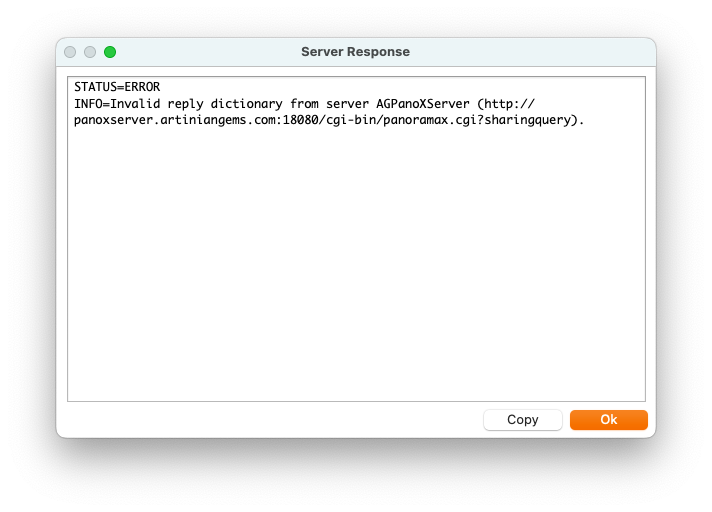

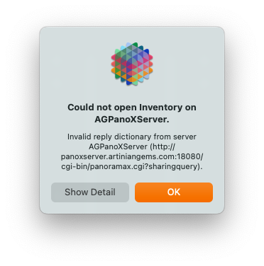

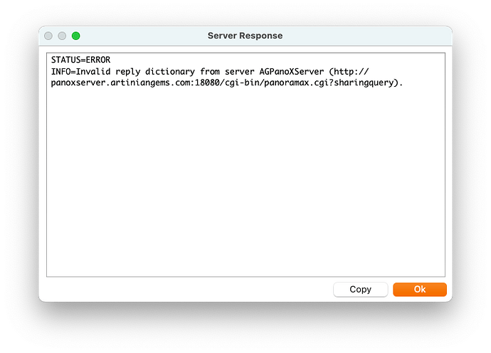

The one piece I was missing was enabling “Web Publish Database”
I tried the URL test without that, and it rendered the database unusable. See attached screenshots for the issues I ran into.
Are you saying after you tried URL test the database wouldn’t work for sharing any more? How did you get it working again? That is very weird.
Yeah. It updated the remote database once, then subsequent attempts to sync with the server generated the dialogs I posted.

I don’t think there is any way to get at any http headers not already explicitly supported by the webserverinfo( function.
