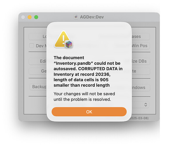

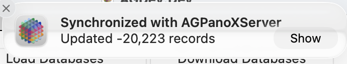

Panorama said it synchronized “-20,223” records … that sounds bad.
Any idea what might have happened?
– Mark
– Mark

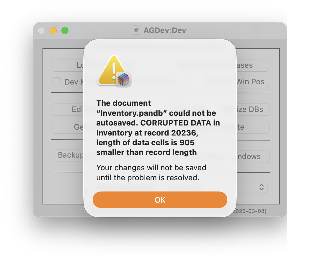

I have no idea how it could possibly display a negative number of synched records. I would have thought that was impossible. I am traveling to a conference this week so I don’t have access to the source code to investigate this immediately.
Your second message provides a potential clue though - somehow it would appear that the local copy of the database is completely corrupted. If you haven’t done so already, I would suggest throwing that local copy in the trash and downloading a fresh copy from the server.
