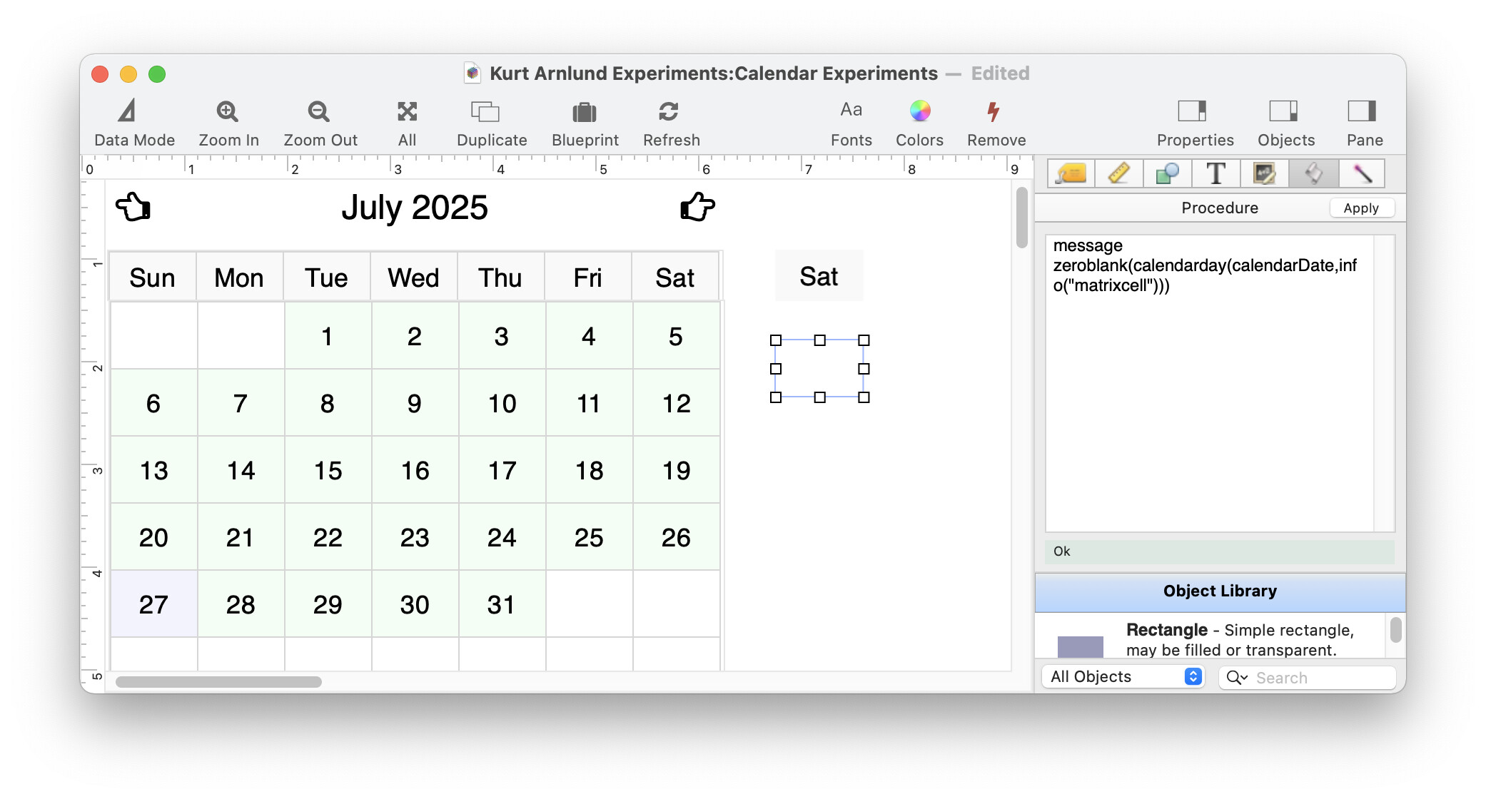

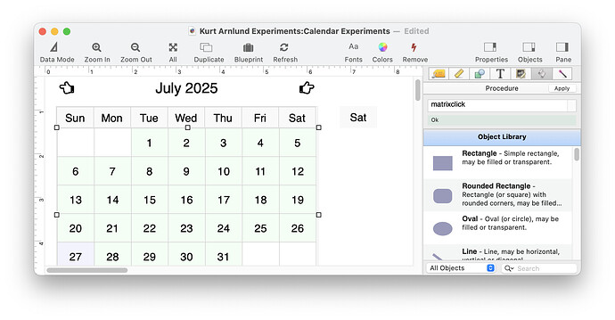

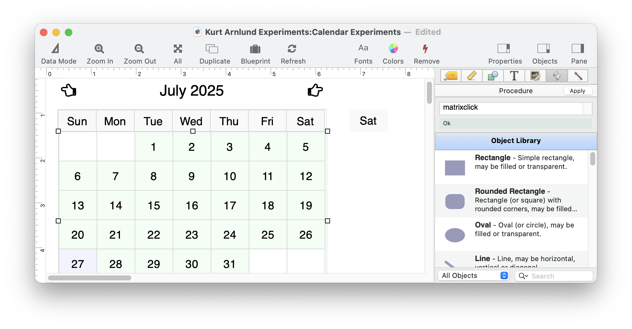

So, to get this to work, I first clicked on the main matrix object and added the code matrixclick to that object.

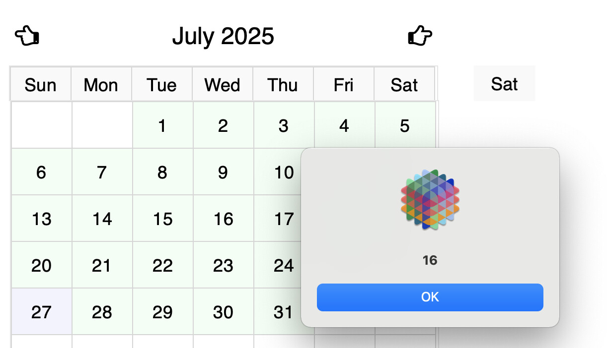

Then I clicked on the text display object and put some code in there. Note that this object does not have a name - a name is not necessary.
Now if I go into graphics mode and click on a day, the code in the text display object is executed - in this case it displays the day number.

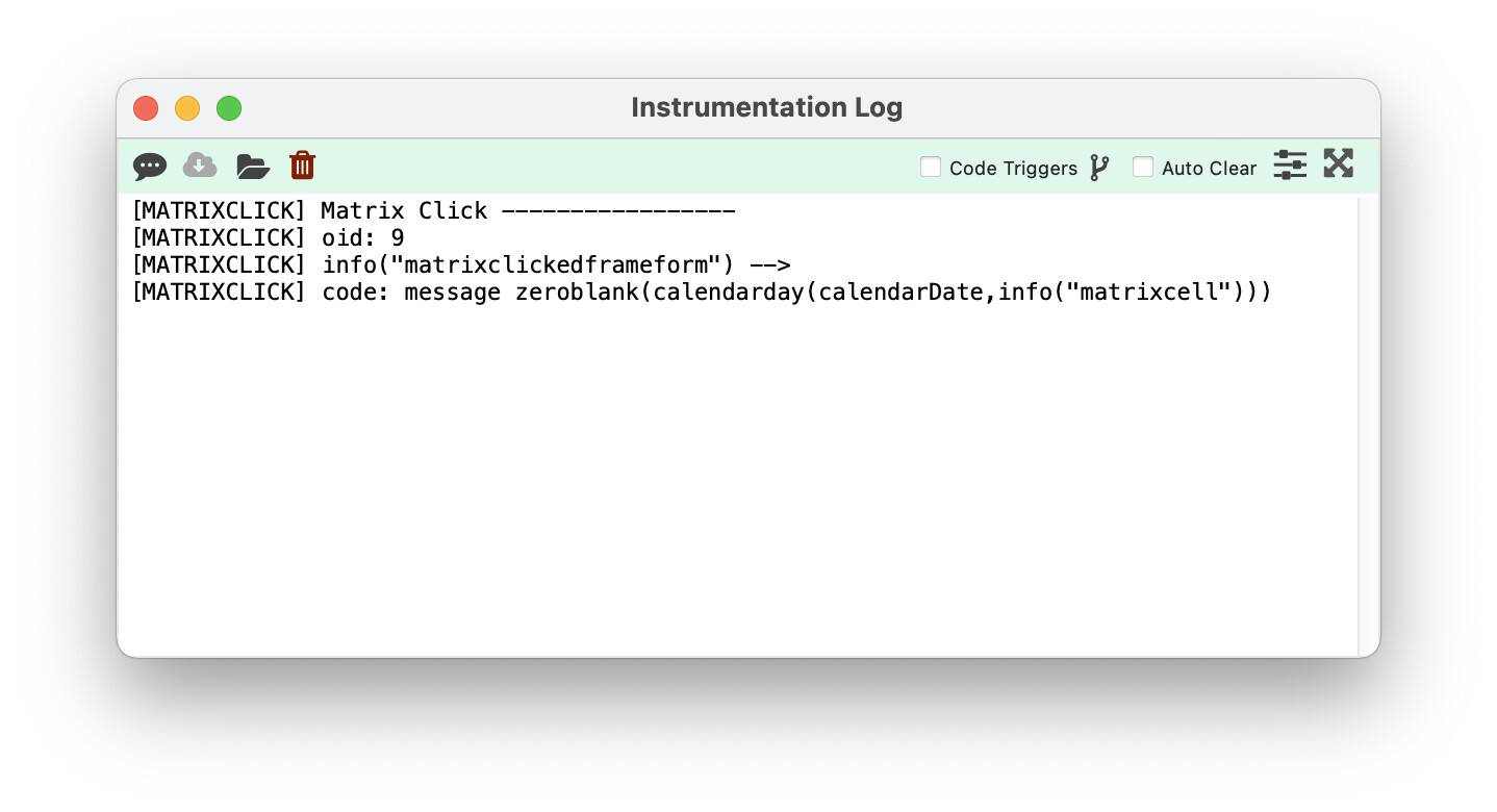

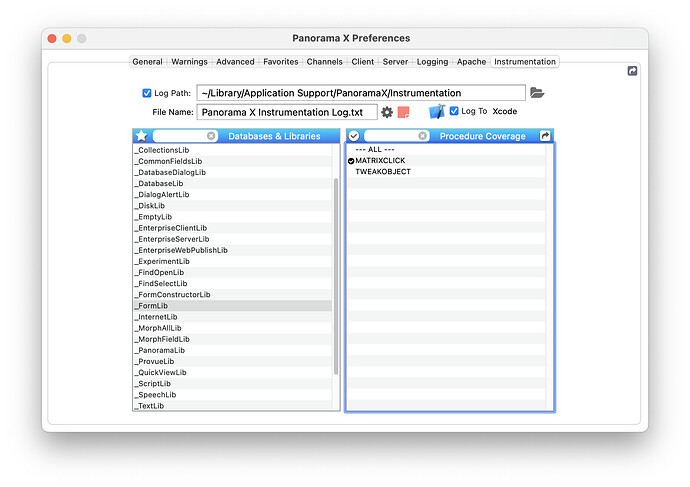

If you have any trouble getting it to work, you can turn on logging for the the MATRIXCLICK procedure.
Then open the Instrumentation Log and click and you’ll see the debug info.

  1. Using the Construct menu, create a calendar.
  2. Click on Matrix Object, and enter ‘matrixclick’ in the Procedure pane.

When I clicked on a cell in the calendar, this was in the log.
[MATRIXCLICK] Matrix Click -----------------
[MATRIXCLICK] oid: 3
[MATRIXCLICK] info("matrixclickedframeform") -->
[MATRIXCLICK] code: letfileglobal calendarDate=monthmath(catcherror(today(),calendarDate),1) showvariables calendarDate

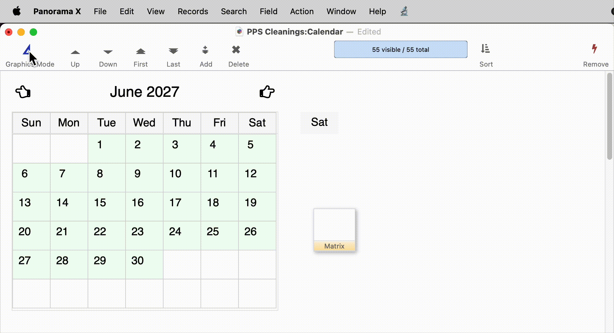

Anyone care to watch this and tell me where I am going wrong?
https://www.dropbox.com/scl/fi/d9k8gq8k1uoythrt1l28n/Panorama-Clicked-Calendar.mov?rlkey=5w9lnoiytukdw4m8b71v3b7bj&dl=0
From your recording, I can’t tell whether you clicked on the Text Display object or the Image Display object.

It fails identically regardless of whether the image display object is used, or the text display object. I have movies of both.
Regardless, neither should cause the procedure to move the month forward.

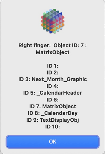

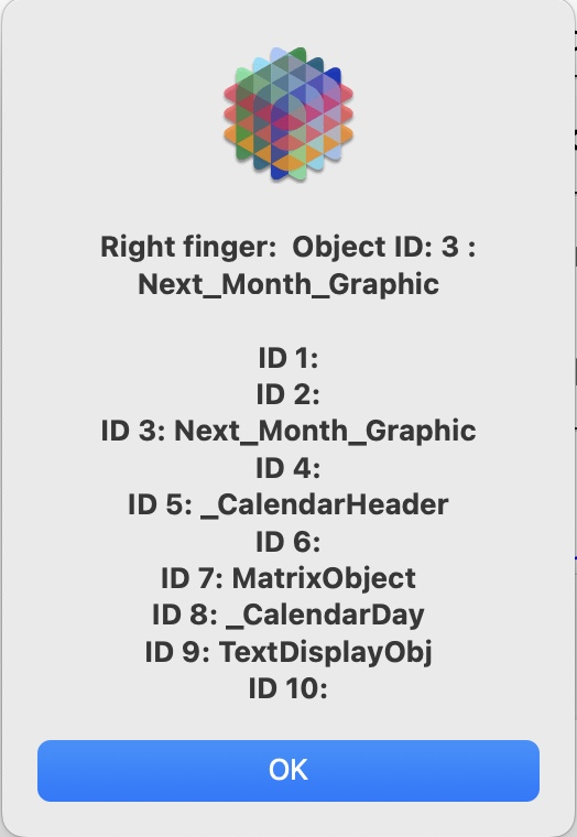

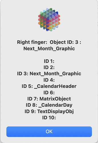

In the Procedure pane of the NextMonthGraphic, I have the following:
Message "Right finger:"+"  Object ID: "+Info("ClickedObjectID") +" : "+ Info("ClickedObjectName")+¶+¶+ objectinfoarray({"ID "+objectinfo("id")+": "+objectinfo("name")})
When I click on the Next Month Graphic, I get this:

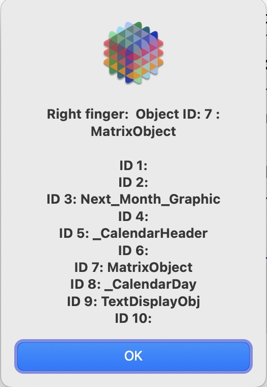

When I click on a cell within the Matrix, I get this:
and the display changes to the next month.

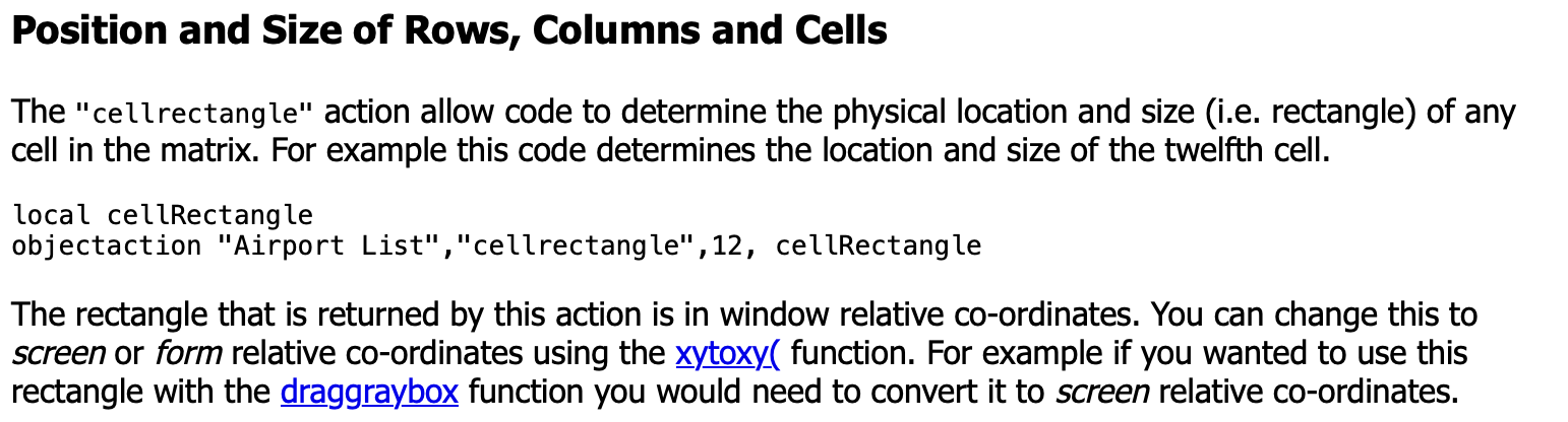

There should be a way to implement multiple clicked areas in a calendar frame. You can use the objectaction cellrectangle function to get the position of a cell.
Then you could check the mouse position relative to the edges of the cell. You would have to hard code the positions of any clickable areas.
You might also find the xytoxy action useful. However, I’m not sure if this works with the old style matrix implementation (fixed # of rows). Looking at the source code I think it does, but I’m not 100% sure.
