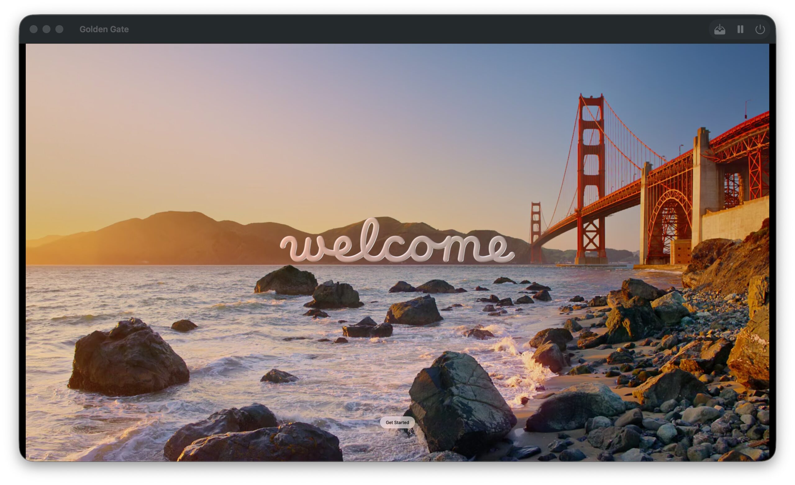

FWIW: I tested macOS 27 Beta in a Virtual Buddy virtual machine and now can confirm the report of databish: I can get to most of the PanX menus only the way databish described: sliding from the Apple menu — with two exceptions: I am not able to activate the “Panorama X” menu neither the “Help” menu. Quitting Panorama X is only possible via context menu (right click) on the dock icon.

Jim, I found it in Apple’s Developer portal, close to each of the beta downloads of macOS 27. The name was something like “Mobile Support”. It was not a big download, just a few MB.
I followed the step by step imstructions in this article on OS X Daily:
as well as the instructions inside of Virtual Buddy. — Make sure you download Virtual Buddy in version 2.2b3 or newer from GitHub!
Thanks, that’s exactly what I was looking for. So far I’m having quite a difficult time with the first step, installing Tahoe 26.6 - the download keeps stalling. So far no luck in over 30 hours, but hopefully that will clear up.
In the meantime, thanks to a friend of mine I just was able to VNC into a system running the Golden Gate beta. Here are my results:
