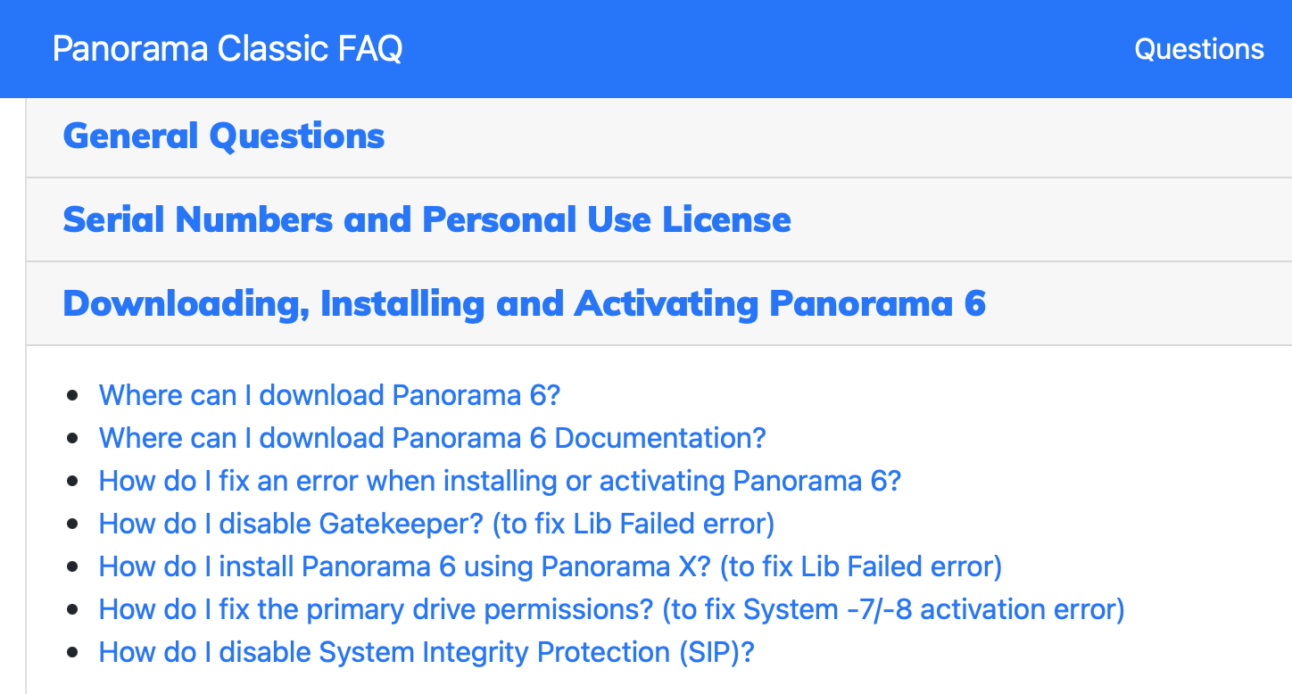

There are special instructions for installing Panorama 6 on Sierra or Mojave. I think this is what some of the posters above mean by “tricky.” You can find the detailed instructions on this page.
