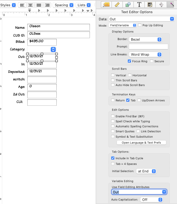

Two central fields in my entry form, both date type, are returning the error message “Filed or Variable [Out] does not exist”. («Out» is when the invoice goes out and «In» is when the payment arrives.) Yet both fields take input without complaint in the Sheet. The form and the sheet contain the same info, and I don’t see field attributes in the form’s attributes panel that would cause an error in the form but not the sheet.
Except that in the form’s attribute panel are items more pertinent to a text field than a date field, such as word-wrap and capitalization.

The best I can say is the trouble starts when I’m tabbing out of «Out». If I try to reactivate the field TEobject, it locks up all the others up. Then at various times, when trying to tab out, I’ve had these two alerts thrown at me.
If I somehow can get into the next field («In»), Tab acts as if it’s in a text field, moving the insert point 1/2” to the R with each tab.

I can’t recreate the error, but you don’t need to have it set to use the Field Editing Attributes under Variable Editing. Just maybe…

It’s clear that you don’t have a Formula, but what about anything entered in the Code?
Nothing in Code. There are other fields which would have formula/code, but not this one. «Out» is used in the .Initialize to update the age, but our problem is one at the point of input.

This is an important clue.
This error message can only occur when some code is running. Since the error message only appears when you do data entry in the form, the code that has the problem must be in the Text Editor object itself. You need to look in the Procedure panel associated with the Text Editor object.
