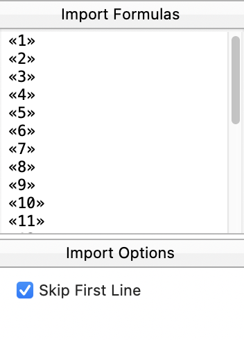

I see that the Import Formulas section at the lower right of the text import window, but it’s not clear to me how to edit those lines to convert ‘yes’ values. I’m willing to do this either way: change my export code in 4D, or convert the data as it is imported into Pan X. Which do you recommend?

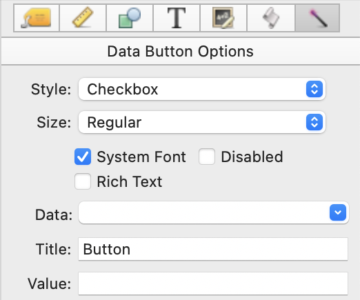

When you setup the data button options, leave the Data option blank.

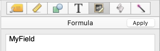

Under the Formula tab, put the name of your field.

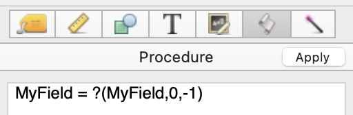

Under the procedure tab use this statement, with the actual name of your field substituting for MyField.
The box will be checked when the value of the field is -1, and unchecked when it is 0. Clicking the box will check or uncheck it as appropriate.

I’d also like to understand more fully how to apply a formula during an import. There’s a place for applying a formula to any field in the Text Import window:
would this formula work if the file being imported used ‘true’ and ‘false’ instead of -1 and 0?
«16»=?(«16»,0,-1)
That’s a statement you have written there, not a formula. The formula I think you are going for is
?(«16» match "true", "-1", «16» match "false", "0","")
That will put “-1” into the text if the 16th column contains the word “true” and it will put “0” into the text if it contains “false”.
