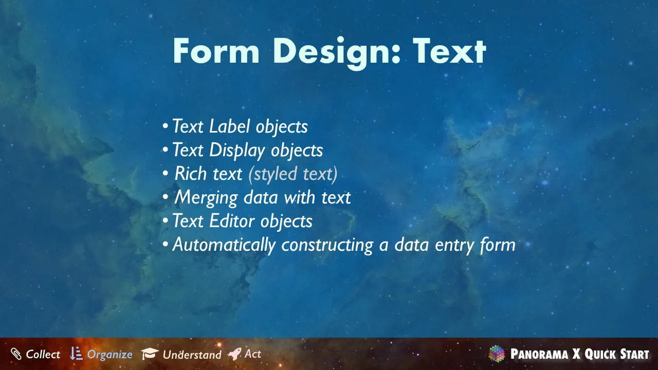

Check the videos in the Help menu for Form Design, and I think it will walk you through this.

I’d also highly recommend this 14 minute video that demonstrates all of the basics of editing and displaying text in a form.
