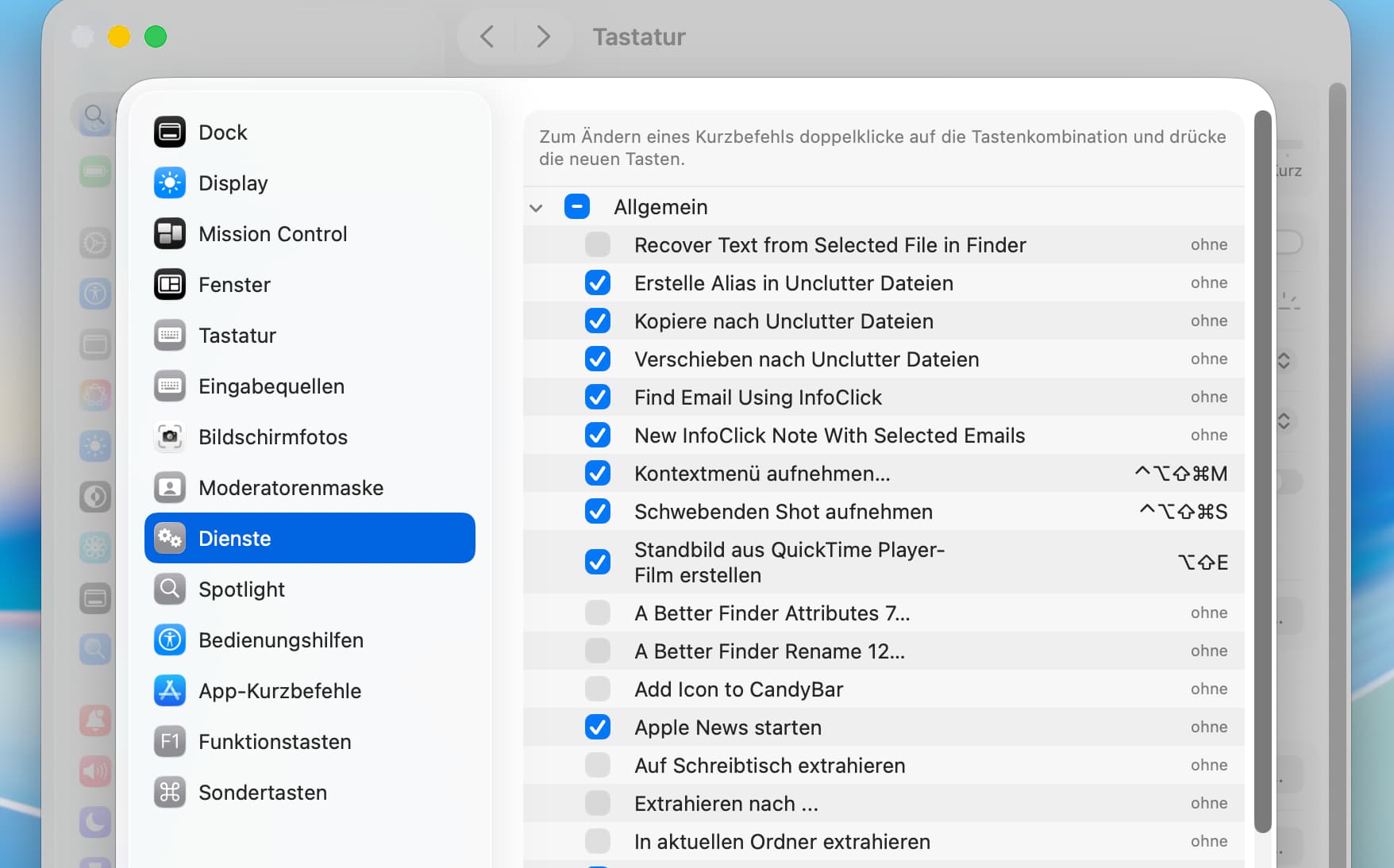

You could check if macOS has new keyboard shortcuts (colliding with your hotkey). Look in System Settings > Keyboard > Keyboard Shortcuts and check specially the shortcuts for accessibility, for services, and apps.
Kurt, good idea. I am astounded by how many possible hot keys one can set up on the Mac. But I did not find any keys that use the Escape key.
