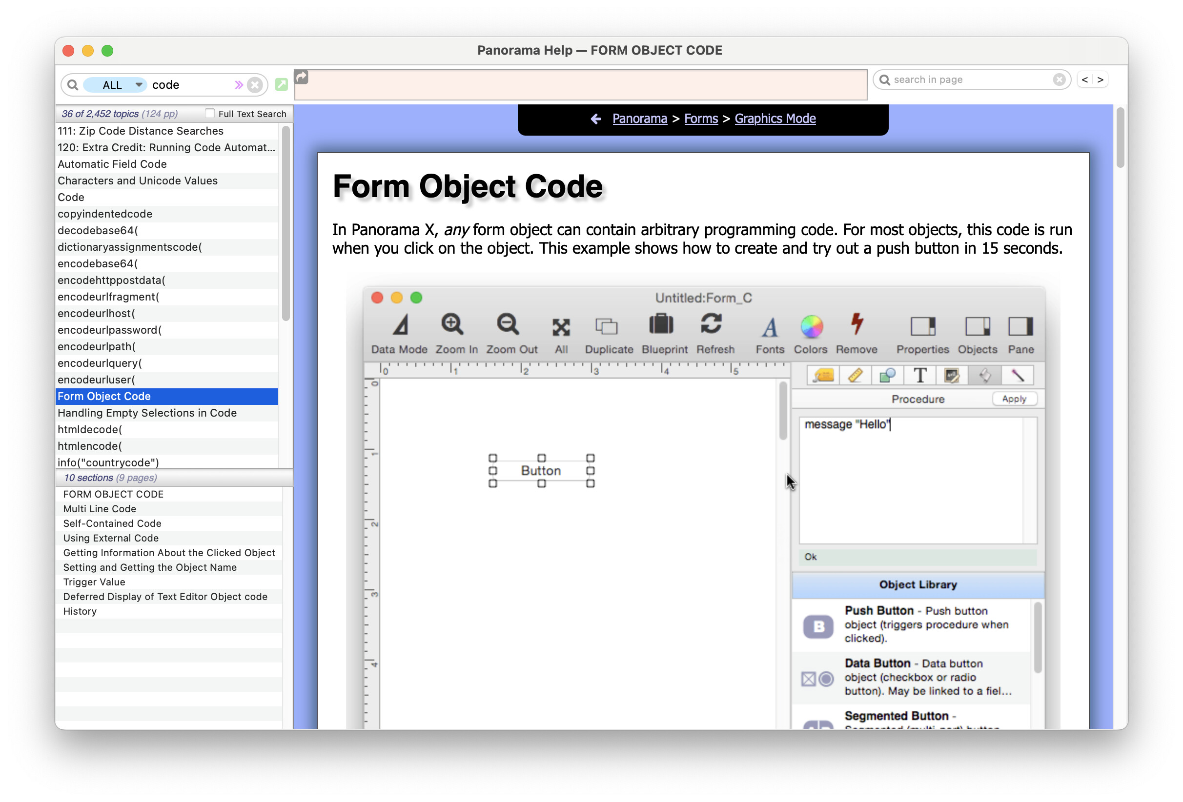

Switch to Graphics Mode: Press Command-Option-G or choose Form > Graphics Mode.
Select the Text Editor: Click once on the specific Text Editor object to select it.
Open Object Properties: Open the Blueprint or Properties panel on the right side of the screen.
Click the Procedure Tab: Look for the icon resembling a magic wand at the top of the properties panel.
Inspect the Code: The text area below will display the exact anonymous procedure that runs when data entry concludes.”
Everything performs except the last step. Clicking the Wand does not show me a procedure, It shows me a whole pile of options pertaining to text editing, and none of those options takes me to the procedure.

More details about editing object code can be found on this help page.

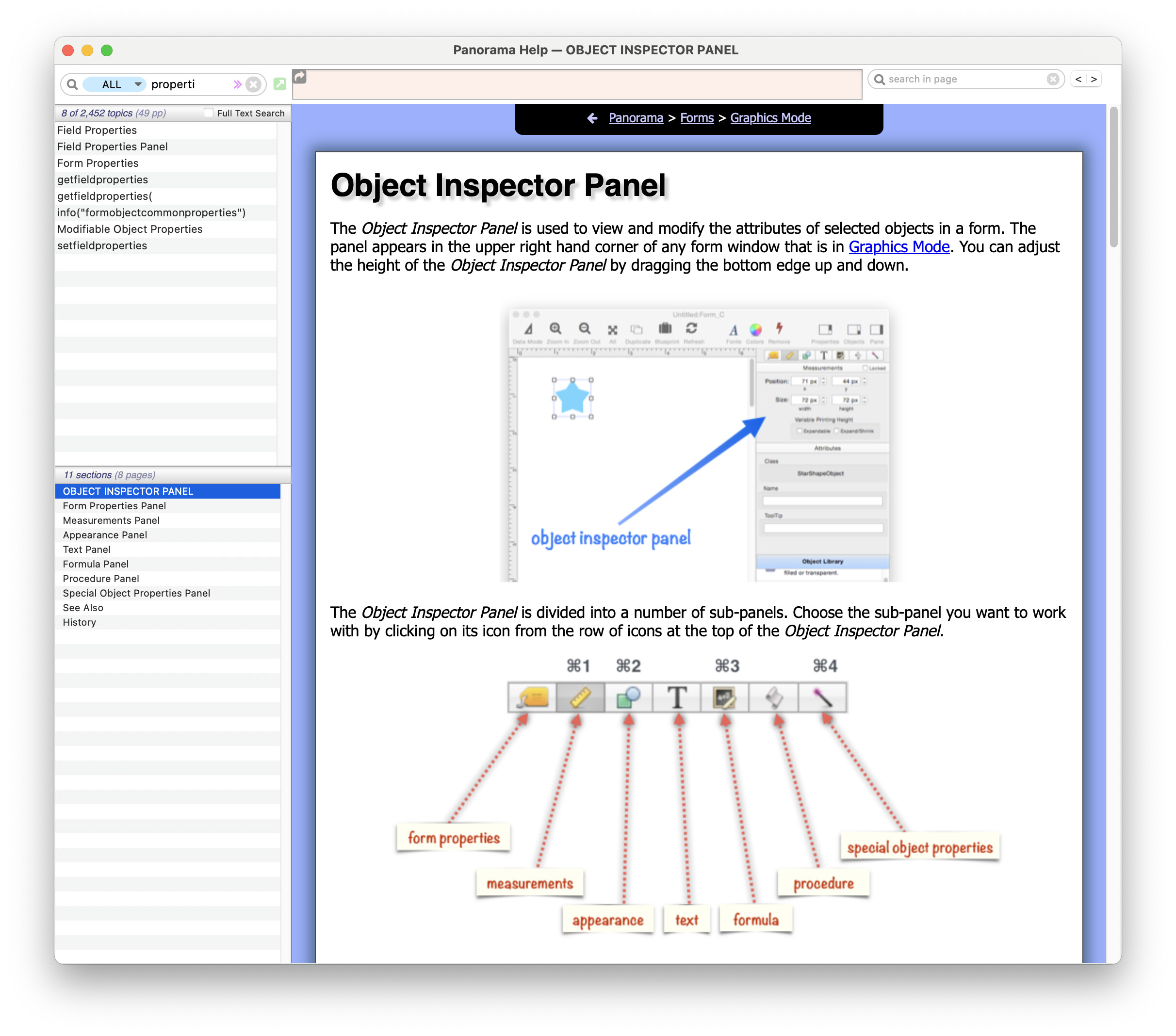

Field properties would have been my next suggestion, but you seemed so confident that you had put the code in the object I didn’t mention it.
If the code is intended to run every time the field is modified, then Field Properties is usually the best place for it. But keep in mind, a Text Editor object might be tied to a variable, not a field. In that case, there are no Field Properties, so the object is the only way that code can be attached to the editor.

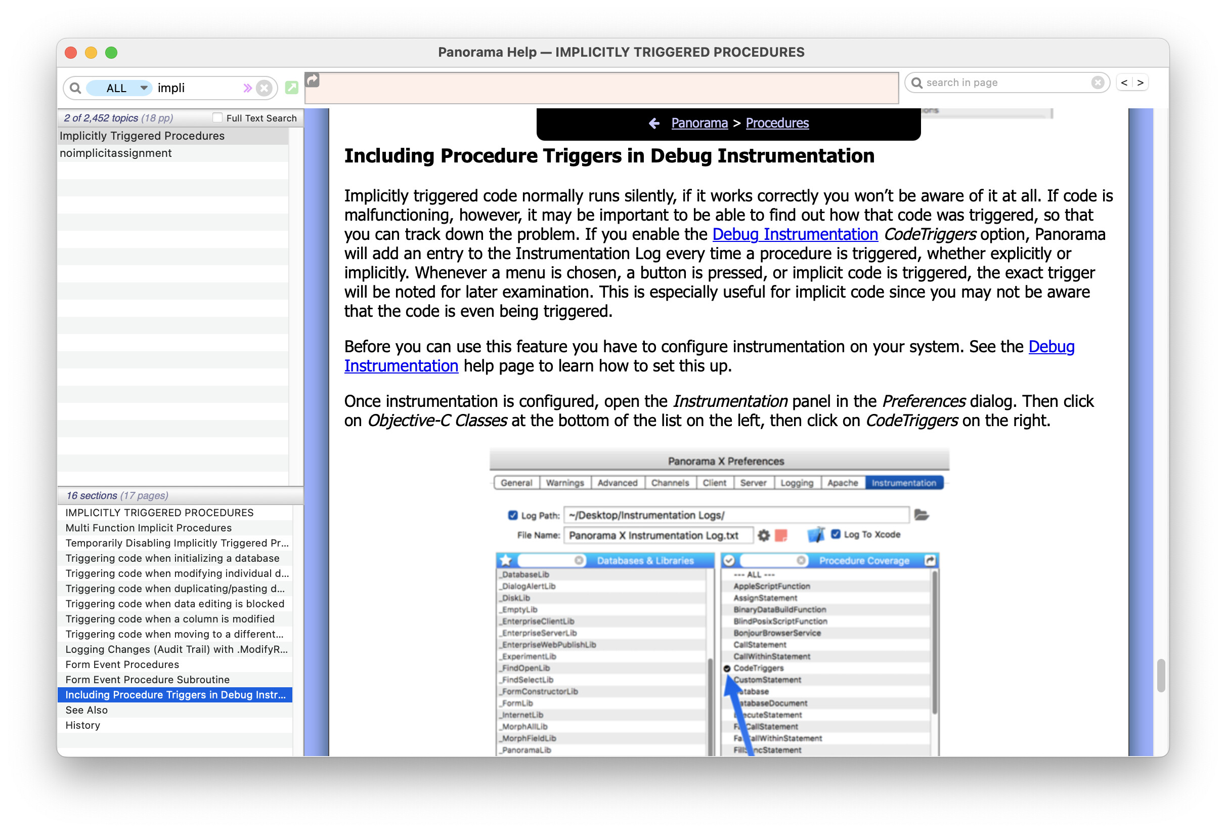

If you’re ever in doubt as to how some code got triggered, Panorama has a feature just for you. Simply enable the CodeTriggers option, then look in the Instrumentation Log and you’ll see exactly how code got triggered. It’s great for situations like this where you may have forgotten how you structured your code.
