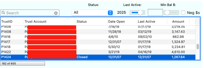

I have a text display list that is compiled partly using an aggregate statement to get the total value of transactions from a different database. What I would like to be able to do is display a total for the selected records. For example in the “Status” popup menu I can select a subset of the records. I would like to know what the total value is in just those accounts that are selected. I expect that internally Panorama is storing the data being displayed in a variable. Is it possible to access it? If so, then I could use an arraynumerictotal( in conjunction with arraycolumn(
I realize I could do it by placing the initial selection into a variable and then have a procedure redefine the variable based on the selection, but since that is already built into the text display object, I wondered if there was a simpler way.
The Text List is not storing the displayed text in a variable, or anywhere else for that matter. It’s simply calculating the list and displaying it, but not keeping the list.
However, that’s ok - what you need is the aggregate( function.

Maybe you mean you are calculating each Amount with an aggregate( function? So maybe using a loop or arrayfilter? If so, then I would suggest that you use whatever formula you’re using now but instead of putting that formula into the Text List, put it into a variable. Then you can have the Text List display the variable, and you can also have further code to calculate the grand total with arraynumerictotal( as you are thinking.
Yes, I meant the aggregate( function. Thanks for confirming my suspicion on the text list. By the way, the aggregate function is incredibly useful, especially in accounting related applications.
