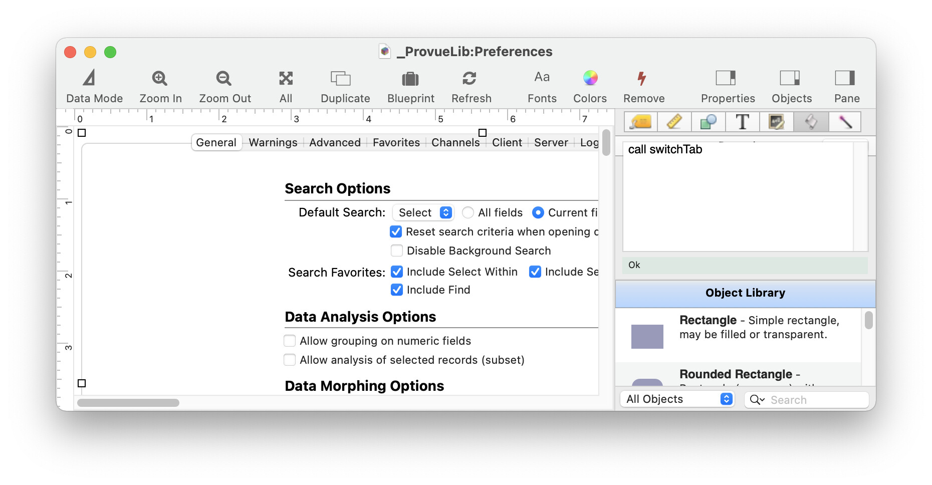

For code that you want to run when you click to make a tab panel active, that code needs to be part of the Tab Panel object. It’s just like any other button.

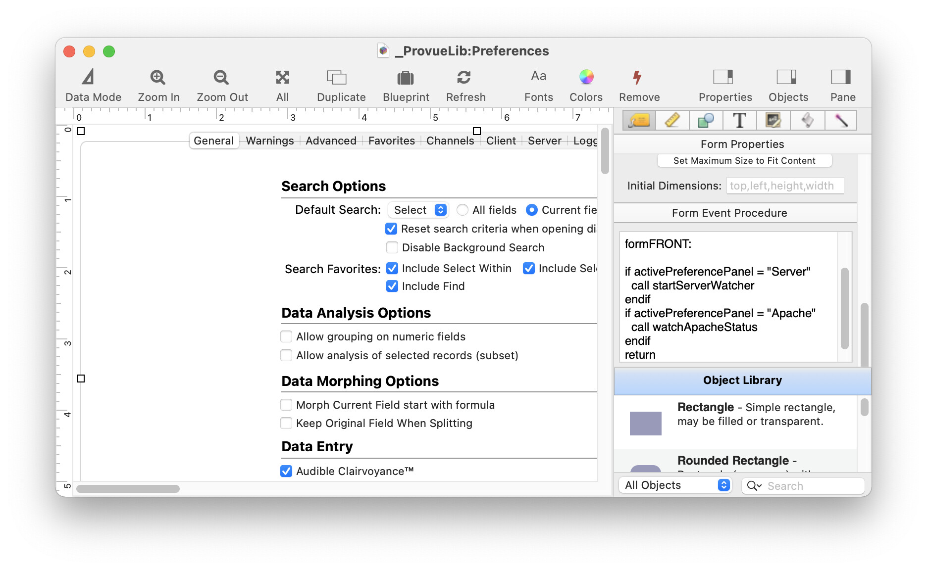

For example, the tab panel in the Panorama Preferences window has this code in it.
Here’s part of the logic of the switchTab procedure:
The form also has an event procedure that initializes whatever panel happens to be active when the window is brought to the front.
I suppose it’s theoretically possible that this could be set up to happen automatically, but it would be quite tricky – especially when you consider that a single form can contain two or more tab panels. So I’m not planning any changes in how this works.
