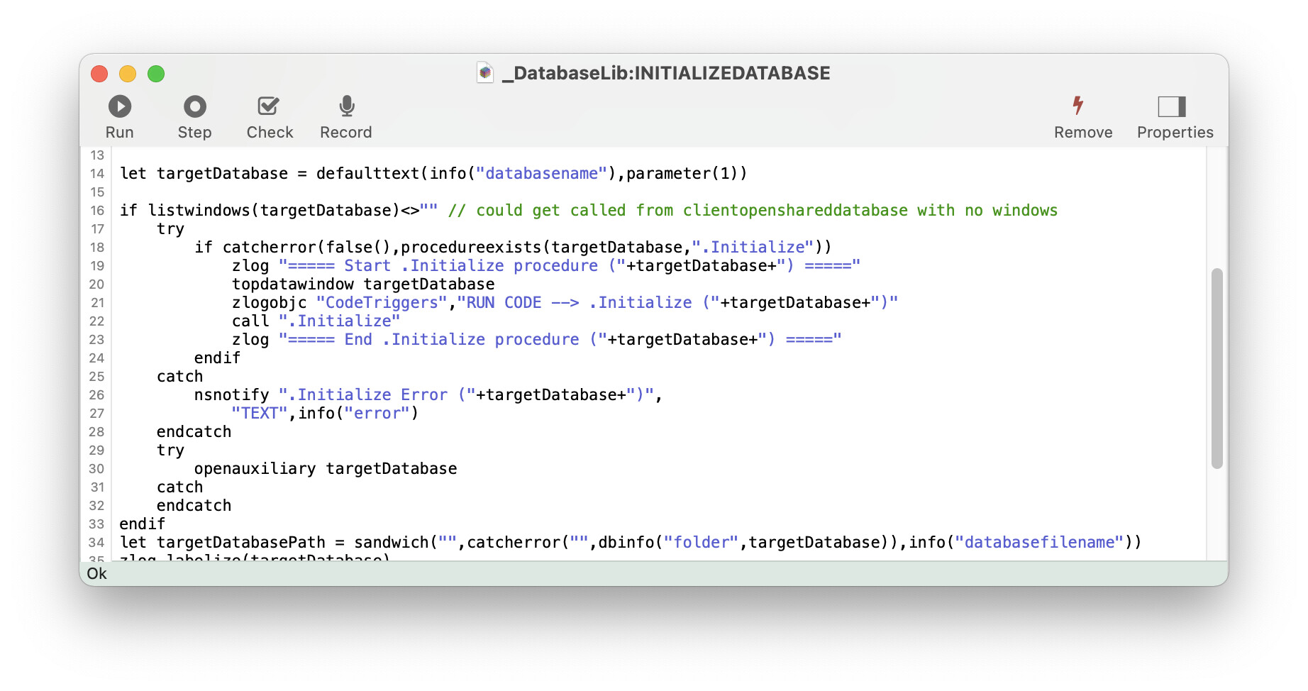

As you can see, if an .Initialize Error appears, that is caused by an error in your .Initialize code. This message has nothing to do with your Form Event code. The Form Event code is entirely separate from the .Initialize code, and doesn’t run until later.
Since you haven’t shared any of the code with us, I’m left stumbling about in the dark to some extent. But I’m guessing that though you have moved some code from the .Initialize procedure to the Form Event code, there is still some code left in the .Initialize procedure, and that is the source of the error.
It makes sense that changing the Form Event code doesn’t have any effect, because that is not where the error is occurring.

I’m not going to be able to debug a complex problem with no code, probably wouldn’t be able to debug it without the databases in question on my computer. The symptoms you describe make no sense to me.
That said, I have an alternate suggestion for you. First of all, I would suggest adding catcherror("", to the formula in the object (Text Display, etc.). That way you’ll never seen an error. I do this all the time now, in fact, in a future version I’m planning to add a checkbox that will do this for you.
Secondly, I would suggest adding this code at the end of your .Initialize procedure, and leave the Form Event code empty.
When the .Initialize code runs, it’s too soon to display the variables. Using the wait statement will cause the remaining code to run later, after Panorama has finished the entire “open” process. Note that this isn’t about a time delay, but about not running the code until the next cycle of the “run loop” happens.
I believe the setactivedatabase statement is needed because most likely some other database might be active at that point, though I’m not sure about that, perhaps that line can be left out.

I’m glad it’s resolved, but that’s very mysterious. As you can see in the code above, Panorama literally calls the .Initialize code, then immediately opens the auxiliary databases. Hmm, one possible clue – the last thing the openauxiliary statement does is use the topdatawindow statement to bring the original database back to the front. If you’re not using the auxiliary feature, that isn’t happening.
