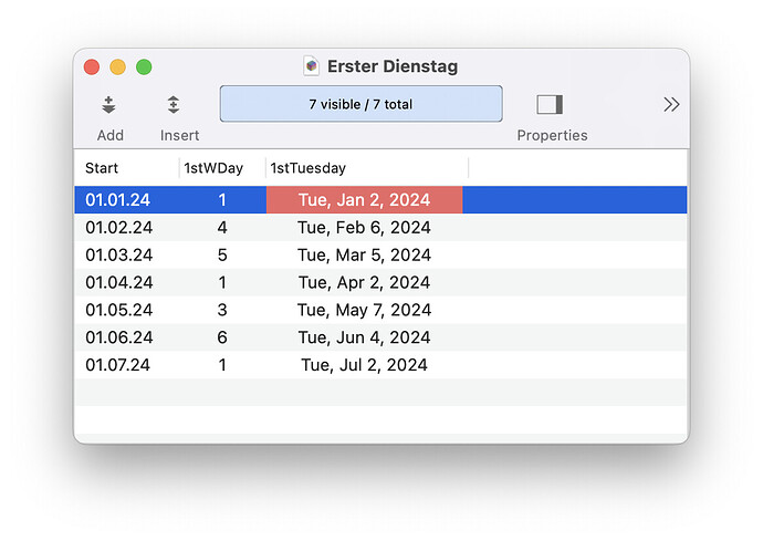

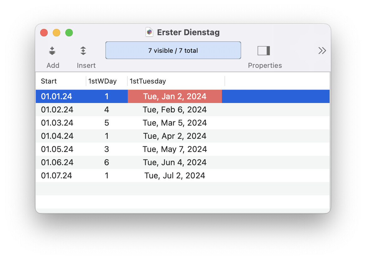

In my sample this code calculates the first Tuesdays:
field «1stWDay»
formulafill dayofweek(month1st(Start))
field «1stTuesday»
Formulafill ?(«1stWDay» > 2,Start + 9 - «1stWDay»,
    ?(«1stWDay» = 2,Start,
    Start + (2 - «1stWDay»)))

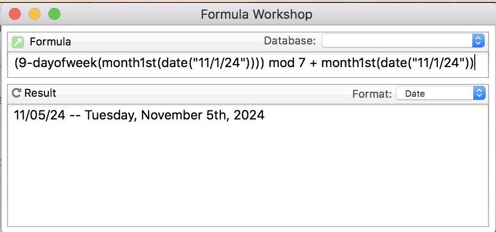

Here is an example of a formula to calculate the date of the first Tuesday in November this year.
The date in the parameter of the month1st( function can be any date in the month in question.
