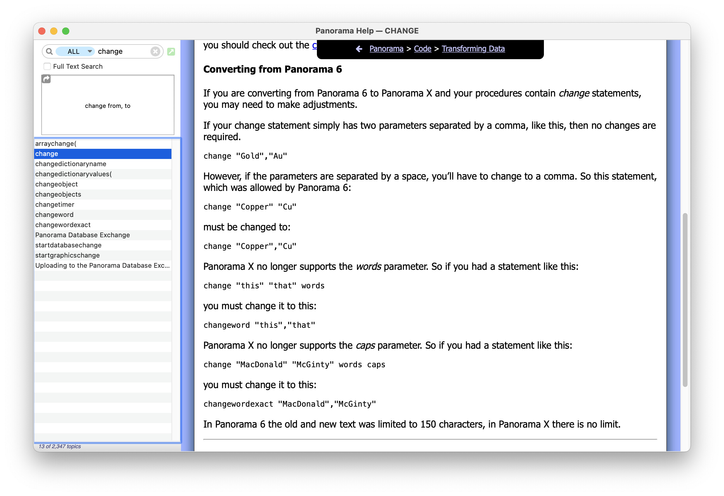

In the original procedure the carriage returns weren’t being removed by the stripprintable( function, they were being eliminated by the change statement. However, the syntax of the change statement is stricter in Panorama X, and the way you were using it did not work.
I think simply putting a comma between the parameters would have fixed your original code. However, I think Jim Cook’s solution using the replace( function is definitely better, so I would stick with that.
