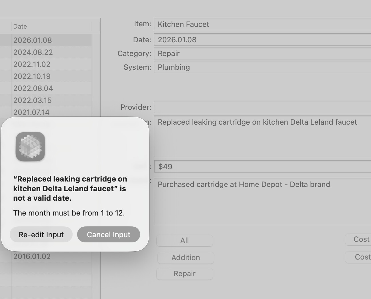

I have a form with a field, “Description”. When I am editing that field (blinking cursor is in the field) on the form then run a procedure (while the blinking cursor is still in the description field) to filter by another field (in the case Category). It filters correctly and all seems fine. But If I click on an area on the form other than in a field, button, text, etc., it shows this message:
This is the procedure:
The only field formatted as a date is “Date”. This also happens when editing any field other than date.
I’m sorry if my description of this is not clear. It’s hard for me to describe. I reformatted my date to match exactly the date format in Mac OS. It’s not the one I generally use but it’s one that I can match exactly with Pan X date format.
Any thoughts?
This sounds like it may have been a similar issue. I tried adding “wait” statement to the procedure but it didn’t work. Sorting a date field after editing another field displays error
Where did you enter the Wait 0 statement? It should go right before the Field Date statement and after the Select statement.

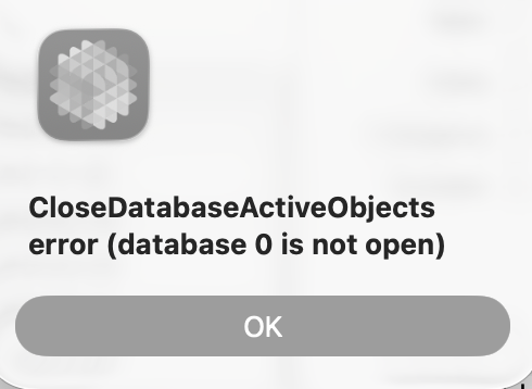

I would suggest putting the statement
closeactiveobject
at the top of the procedure. Or, alternately, this statement:
closedatabaseactiveobjects
Wait 0 above field Date.
This works.
This gives this error:
Thank you. Will update all of my procedures.
I went back and read the documentation. With brief testing, this seems to work when the name of the database is added to the statement. I didn’t do this the first time I tried it.
closedatabaseactiveobjects “Name of database”
Again, Thank you.
