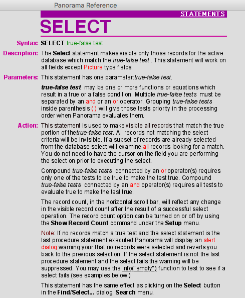

This result of selecting all for empty selections is not the way it worked in Panorama 6 and not the way it was documented in Panorama X until a couple of days ago. (See the notes on empty sections in the Pan 6 documentation below) I tend to read documentation and have especially appreciated the Help system in Pan X.

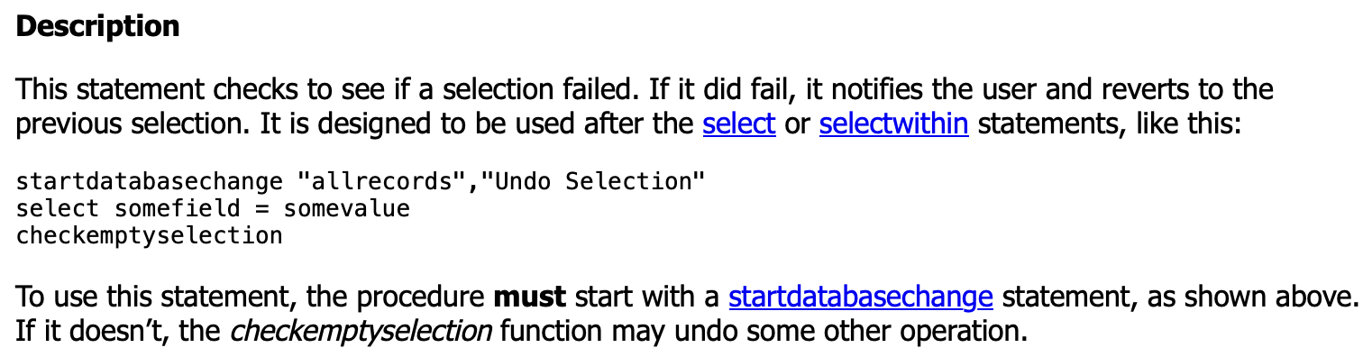

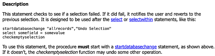

As for how I ended up using CheckEmptySelection, that came from a previous thread here as well as from the Pan X documentation.
From SelectWithin
and from CheckEmptySelection

Aside from the attached Pan 6 documentation below, I’ll close by saying we’re all human. Errors in documentation and coding happen and none is expected to be free of errors. I have no desire to beat up on anyone and remain one of the biggest fans of Panorama. But as I’ve done for many years, I’ll make a fuss when I don’t think things are right. I’d like to think that those of us who do have made our own contributions to making it that much better for all.
From Panorama 6 Documentation:
If I haven’t made it clear before, let me say it explicitly now – this was a documentation error on my part. The behavior of selection changed, but I didn’t recognize that when copied old Panorama 6 documentation and revised it for Panorama X.
