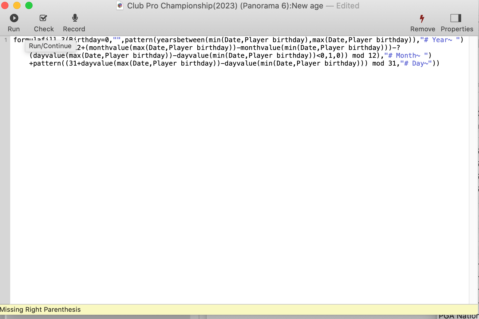

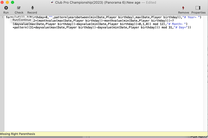

I tried both Date Difference and Age, and both times I got an error
Missing Right Parenthesis. So were am I suppose to put that???
It appears that all quotation marks have been converted to curly ones. Changing them will work fine.

Still getting error
Yes the field is Player birthday, not Birthdate
