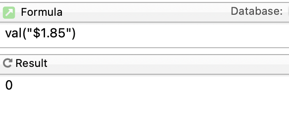

Use val(myCredit)-val(myDebit)
Depending on the pattern. $ signs could mess that up.
