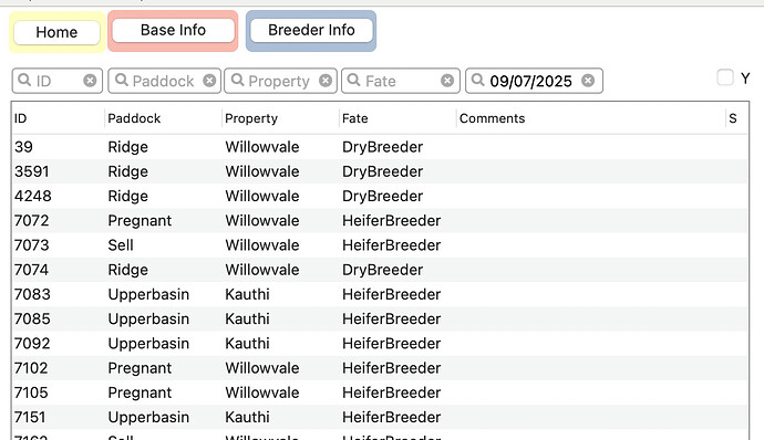

I’m using table filters to search my data. I would like to search by date. Is it possible to have the filter variable show the same flexibility of date interpretation as the panorama database search? (In other words, if I type in 9/7, for it to be recognised as 09/07/2025, rather than needing to exactly match that format for it to work?
This is what I have currently - it requires an exact format match:
((«selectSearch» = “”) or («Check» contains «selectSearch»)) and ((«paddockSearch» = “”) or («Paddock») contains «paddockSearch») and ((«propertySearch» = “”) or («Property») contains «propertySearch») and ((«fateSearch» = “”) or (exportcell(«Fate») contains «fateSearch»)) and ((«idSearch» = “”) or (exportcell(«TotalID») contains «idSearch») or (exportcell(«Unique») contains «idSearch»)) and ((«sellSearch» = “”) or («Sell» contains «sellSearch»)) and ((«whpSearch» = “”) or («WHP»)>today() or («ESI»)>today()) and ((«dateSearch» = “”) or (exportcell(«DateSeen») contains «dateSearch»))
