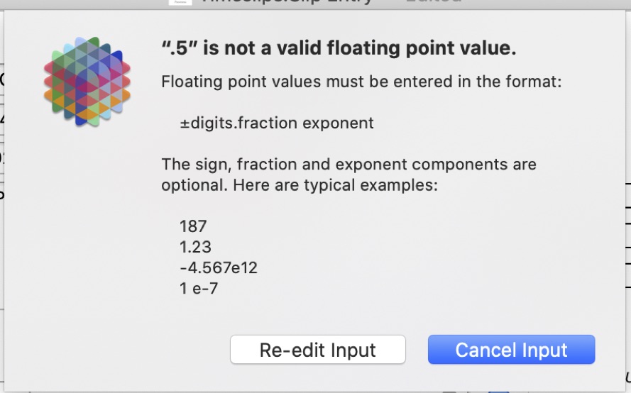

When I enter .5 into a text editor for floating point data, I get this error message:
I assume this is part of the new data validation feature (which I think is excellent and going to be very useful.) 0.5 is accepted.
Ok. I can confirm this. I’ll look into it.
Fixed this, thanks.
