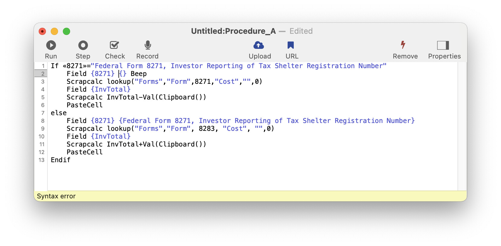

I’ve been tasked to finally convert some old but necessary dbs to Pano X and some of the conversion is not fun. In the currrent db, I have 132 procedures like that below. Old style code that worked fine in Pano 6 but no more. The code shows the previously acceptable assignment method. With so much code to walk through and clean up, might this be something that the conversion can do a bit more with for those that will find it daunting to convert?
BTW, I found in the old code SaveAll and OldSelect
I see no replacement for SaveAll and I’ve no clue what OldSelect did. Anyone remember?
If «8271»="Federal Form 8271, Investor Reporting of Tax Shelter Registration Number"
    Field {8271} {} Beep
    Scrapcalc lookup("Forms","Form",8271,"Cost","",0)
    Field {InvTotal}
    Scrapcalc InvTotal-Val(Clipboard())
    PasteCell
else
    Field {8271} {Federal Form 8271, Investor Reporting of Tax Shelter Registration Number}
    Scrapcalc lookup("Forms","Form", 8283, "Cost", "",0)
    Field {InvTotal}
    Scrapcalc InvTotal+Val(Clipboard())
    PasteCell
Endif

This is what is called an “implicit assignment”. You should change this code to:
«8271» = ""
Until I think Panorama 2.0, there was no assignment statement. If code contained text, it would just plop that into the current cell. The problem was that it was easy to do that accidentally, destroying data in the process without even realizing it was happening. For example, consider this code. In Panorama 1 thru 5.5, this code would display the message hello, then put goodbye into the current cell. An easy mistake to make.
message "hello" "goodbye"
So 20 years after the assignment statement was added, I made use of the assignment statement mandatory in Panorama 6. However, many people howled at the necessary code changes, so a preference was added in Panorama 6 to continue to allow implicit assignments for the time being. At that time it was strongly recommended that anyone still using implicit assignments should remove them from their code, and that a future version of Panorama would not support them at all. Panorama X is that version.
Other than the implicit assignment, this code should all work. I just verified that scrapcalc and pastecell work fine. On the other hand, this code would be a lot easier to understand and maintain if it was written in a single line:
InvTotal = InvTotal-lookup("Forms","Form",8271,"Cost","",0)

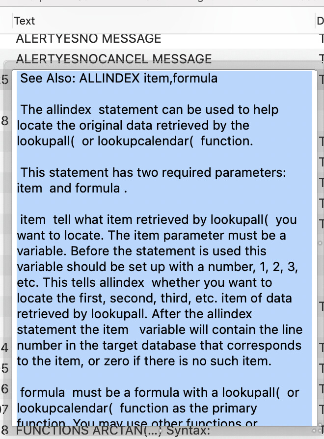

On the list of Unimplemented Functions is ArraySubset. Apparently I used to use that quite a bit. It is shown in Black on that list which implies that it may come back. Is this list still being worked?
(I’m having to rewrite code that I last touched in 1995. It is good stuff, working and complex, but I am believing that the old Mojave computers are going to go dark sometime soon.)
Is there any online documentation of what unimplemented commands and function once did? Some are relatively obvious, others not so much.
Is there something new that would be similar to LiveClairvoyance of yore?
I don’t think there is any online documentation. You might find it useful to know that the Panorama 6 Programming Reference database contains the text of its documentation in a field called Text. That field is there so that the database can be searched. You can add the .pan extension and open it in Pan X. Of course, if you have a working copy of Panorama 6, you can view the database there, where you will still have access to the PICT resources.
ArraySubset was a custom statement in the _ArrayLib library. None of its code appears to have been deprecated.
