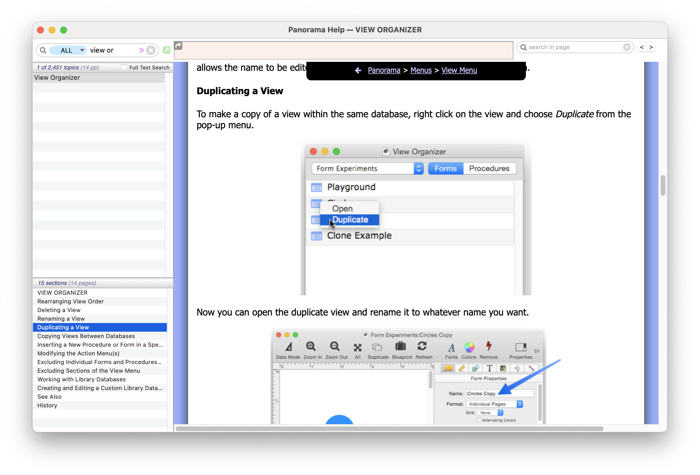

FYI for your purposes using CloneForm was doing it the hard way, you could have simply copied and pasted the items, or used the View Organizer’s duplicate command.
CloneForm is designed for when you want to dynamically copy a form as part of the routine operation of your database. It’s the underlying engine used for Tab Panels.
