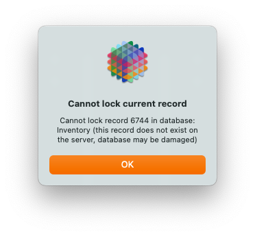

Cannot lock current record
The following started showing up after restarting the server.
There were no sessions connected when the server was restarted.
Any ideas? This is happening on every record I’ve looked at this morning.
if I pull (force synchronize), it looks like a bunch of records are missing from the server.
TIA
If my local copy has all the records, can I just push just the data up to the server and fix it?
I don’t know what you mean by “push the data up”, there is no such capability.
In the situation you describe, the only solution I know of would be to detach the local database from the server, turning it back into a single user database.
Next, you would delete the server copy of the database (using the Server Admin wizard).
The final step would be to convert your detached single user database back into a shared database, which would upload it.
Of course this leaves the mystery of what happened to these records in the first place. I’ve not heard of a problem like this before. I believe you have been writing web code on this database, it is certainly possible to delete records on the server that way. I’m sure you’ve been careful, so that seems unlikely. But you might want to review the web publishing code you’ve written.

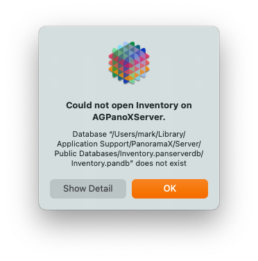

When I follow these steps and attempt to re-upload the single-user database, I get this error. Nearly as if it’s not in “single-user” mode … hmm …
This is the same database that just got the CORRUPTED DATA error message, right? As I mentioned, Panorama checks the data structure before saving, but I don’t think it performs that check before uploading. It really should, but I never thought of that case. If you tried to upload a corrupted database, I can imagine that this scenario would result. As part of the upload process the server software will save the database on the server, but if it is corrupted that won’t work. The code really should be engineered to catch the error earlier in the process, but I don’t think it is.
If you can, it might be worth trying to export the data to a text file and re-importing it into a Panorama database. I’ve never heard of that being necessary in Panorama X, but it seems like that might be a prudent course. Assuming that it’s not too corrupted to perform the export.
