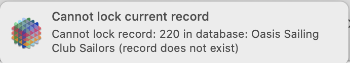

Cannot lock current record. record does not exist
I opened up the single file that I have shared. A message stated Synchonized: 2
1 record deleted.
I thought, hmmm, didn’t realized I’d deleted anything. Proceeded anyway.
Ran 1 procedure which essentially does a Select. Then attempted to edit a record buried within the database (not the 1st record). The result was an error 'Cannot lock current record. Cannot lock - record does not exist.
Tried File/Synchronize Data.
Result: “Already synchronized: 2”
Tried Record/Duplicate Record
A duplicate was created and I then deleted the original ‘corrupted’ record with the warning that it was not undoable as the file was shared but I said fine, go ahead and delete it.

When I open a shared database, I get the comforting 'Already synchronized with ‘Server Name’ notification. But then later, when attemtping to edit a record, I get the…
"Cannot lock current record
Cannot lock record: ‘record number’ in database: ‘db Name’ (record does not exist)
I’ve learned that I can use the Option key with the Records menu and then choose ‘Upload Record’ as a quick fix, but my mind then goes to ‘Hmmm. What other records do not exist?’. Is there a way to determine if there are other records that ‘do not exist’?

Using b25, I received the 'Already synchronized with ’ message. The when I attempted to edit a record, I then got
Panorama Error
error.
All records were locked. The fix was to use Database Options and pretend like I wanted to do a new generation. Upon then later doing the New Generation, all seemed to be good to go.

In my case today, I had just shared a former Panorama 6 database with 5 records. I am the only user. In the DataSheet, I went from the top to the bottom making a change in one field. When I got to the last record, I got the message that the record did not exist and I couldn’t change it. No one deleted anything.
