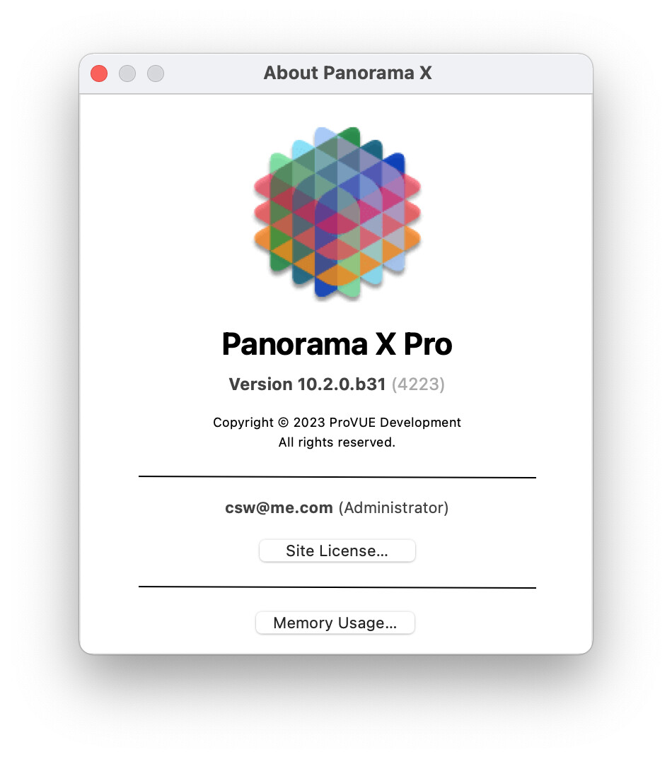

Here’s something that crashes my copy of b31 every time.
Open panorama help
start right-clicking anywhere in the window
Boom
Just want to make sure it’s not just me…

Yep, just tried this and it crashed instantly. Pan X b31 (4223) on my M1 iMac Monterey 12.6.

Watts - do you mean b31? Check for Updates says that’s the latest.
