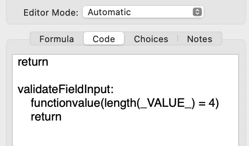

Not sure why, but nothing is happening. The field QTY is a text field, and when I use this code in the Formula box, there are no warnings (the Editor Mode is set to Automatic)…
return
validateFieldInput:
functionvalue(length(VALUE) = 4)
return
I should get an error message when the entry is less than 4 digits.
I also tried…
return
validateFieldInput:
if functionvalue(length(VALUE) = 4)
functionresult true ()
else
functionresult “Not enough digitss”
return
What am I doing wrong?
It goes in the code box, not the formula box. Also _VALUE_ begins and ends with an underscore. You left the underscores off.

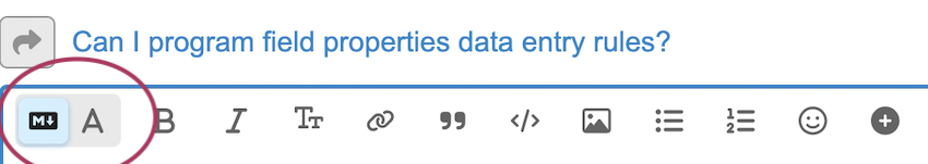

He probably had them in his original text and they were interpreted as tokens to make VALUE italic.
I checked that after I posted, and found asterisks in his raw text, which also would have made them italic. Not sure how that would have happened.
I t looks like if the text entry box is set to Rich Text the underscores are italic tokens. If tlhe entry box is set to Markdown they are not.

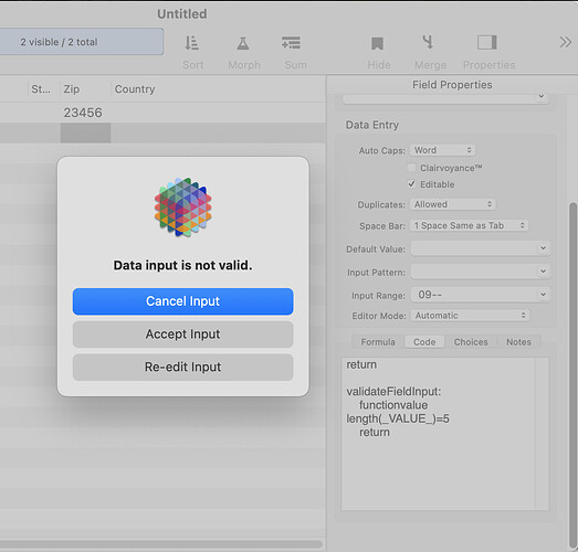

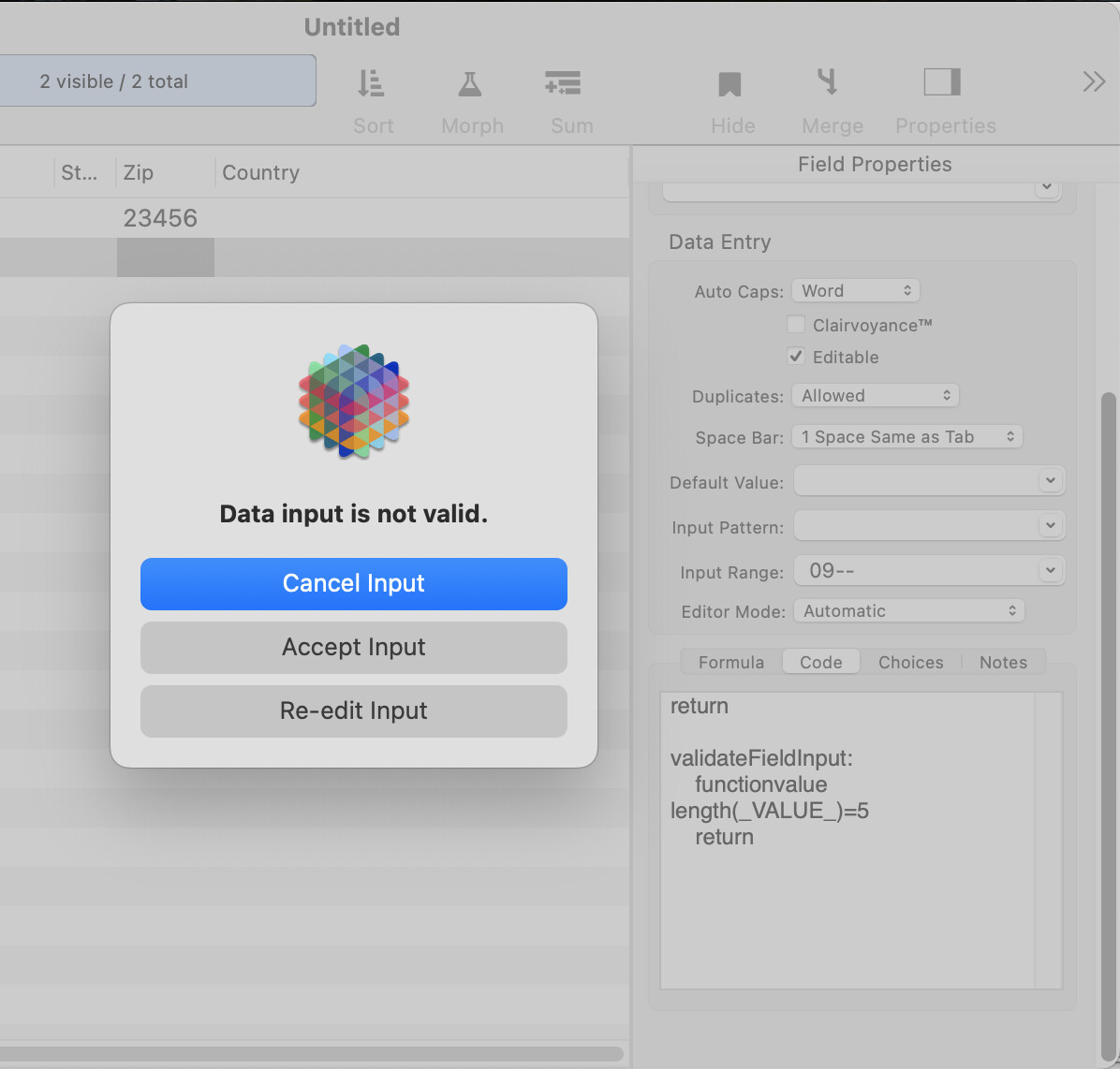

Sorry, I made a slight mistake in the code - functionvalue is a statement, not a function. The correct code is:
return
validateFieldInput:
    functionvalue length(_VALUE_) = 4
    return

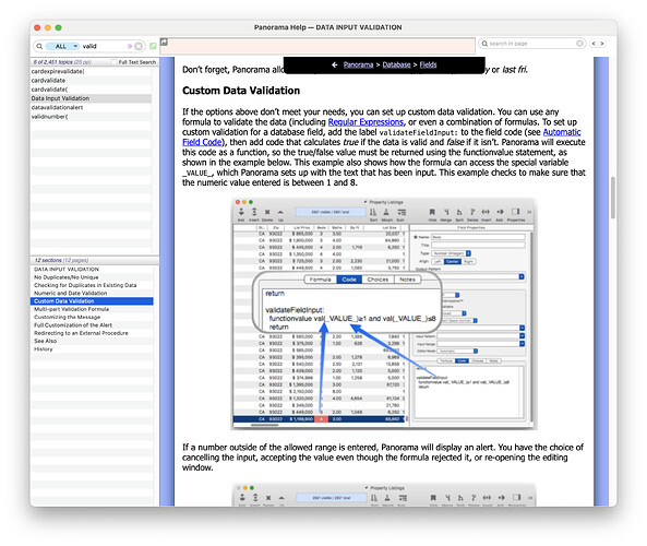

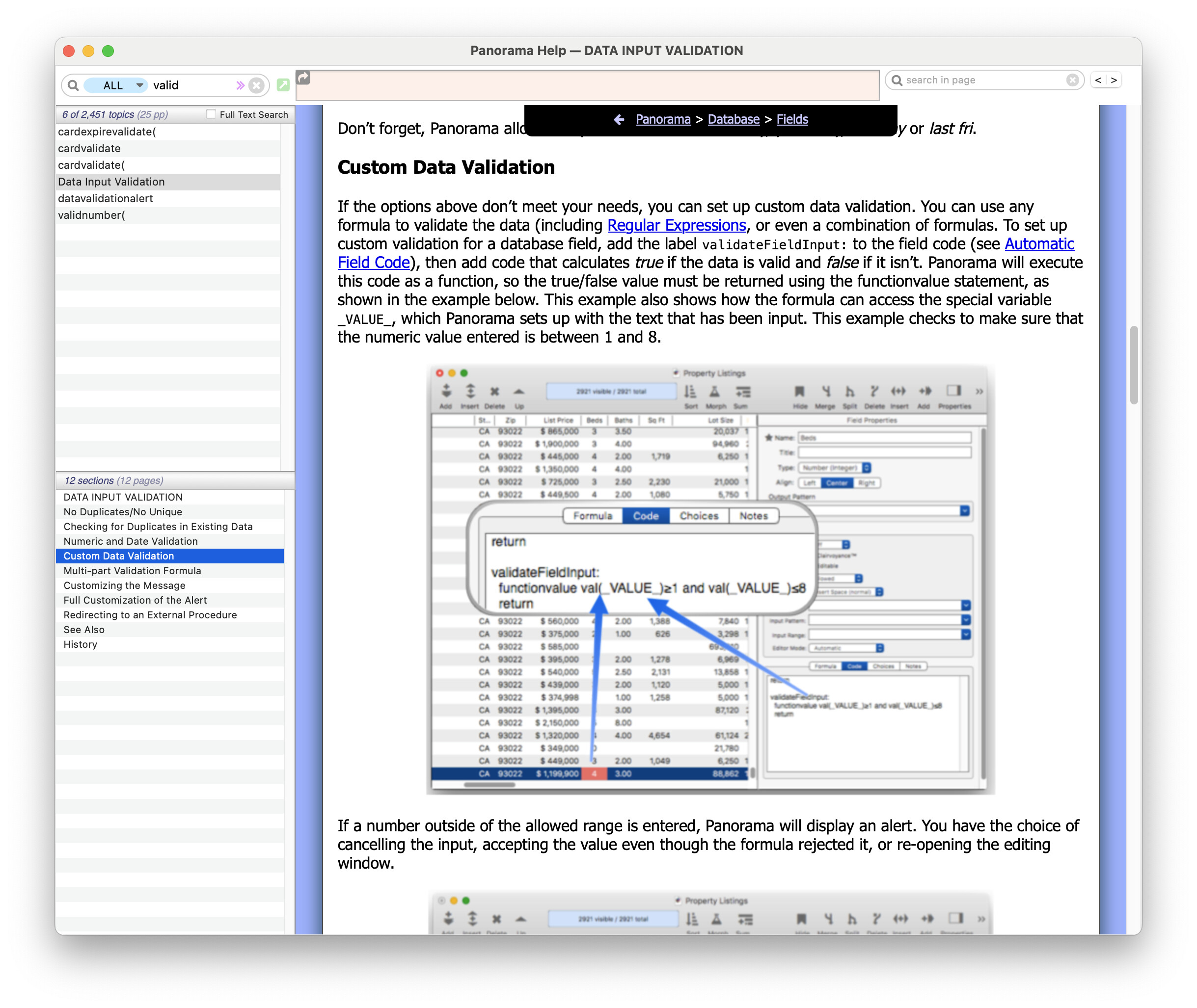

Though I messed up my submission above, the documentation does show the correct code.
I tested it just now and it worked fine.
Yep, that works perfectly and displays the alert if the length of the input is not correct.
